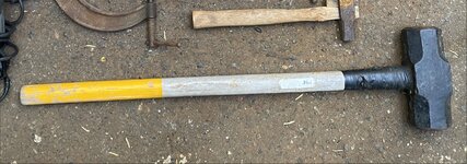

On the subject of sledge hammers, I scored a nice 16 LBer last weekend. It's my biggest sledge.
