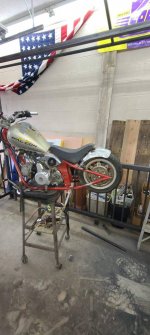

I got sidetracked today, I sold my mini chopper to Gavin, he is Daltons son and he really wanted it so I let him have it.
The back fender was plastic and was broken so I told him I would make him one from steel since the seat is so small you are basically sitting on the fender and it was a safety issue.

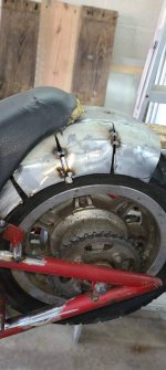

Working on the bike fender again today. Dalton cut me some wedges to fill the gaps in the pie cuts. Had to move the fender mounts a couple of times to locate the fender in a decent looking position and a cutout for the chain to clear
Daltons wedges
There you go Jay thats the easy way to fill the gaps.
Cutting out a notch for the chain
Lots of clerance
Welded up all of the gaps
Ground smooth
Peened the welds to help level the surface.

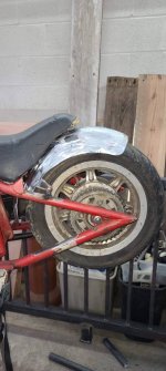

See where the tire was eating the seat
Lots of fender to protect that ****
All cleaned and smooth
First coat of bondo.
