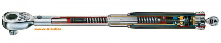

The original flyer was from around 1976 introducing the HAZET own torque wrench series with 6xxx order numbers - development started in 1973 with some patents.
At that time, HAZET was focused not only on the automotive sector but also on industry, aviation, and more - and were proud of the new times ;)
I have it with correct typo:
They previously used rebranded Stahlwille Manoskop models - only a scale display without any click noise.
So these new ones called CT = Click Type - because the die (red in the following image) tips over inside and makes that typical noise as most of these today.
I have two of these first models from 1976-1979 - the HAZET 6121 CT (10 to 120 Nm) and 6122 CT (20 to 200 Nm)
