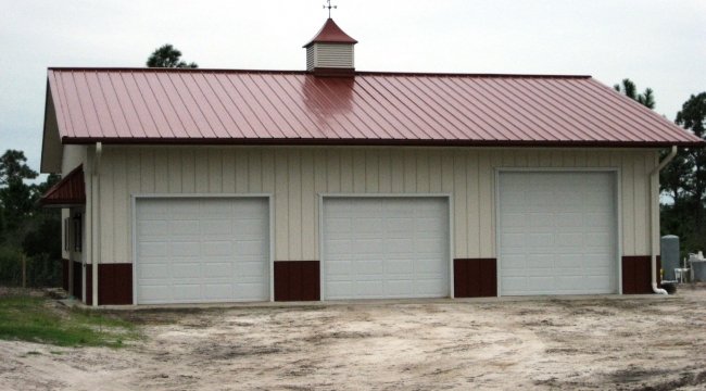

So here are the renderings of the building! I am super excited once I saw them!

So none of the red except for the vertical beams will be seen. There will be a soffit panel underneath the porch and I will put recessed lighting in there for night time. I might put a sconce on either side of the man door. The plain side of the building is the far corner of the property and for security purposes I didn't put any entrances. I plan on installing my home automation / alarm system in here as well but I didn't think it was necessary. I also wasn't sure if I should install gable vents to get air flow but I do plan on air conditioning down the road...

That's a nice looking layout. How come so many roll ups along the side, the three doors? Now this is just me speaking, but I would not want to lose the wall space.
I really like the overhang on the front and I would of also used the columns , you really need them for the wind lift here.

I am planning on the garage being a real garage for cars and such. I thought it made sense for entry and exiting to have space for all that stuff and on a cool day like today I could open it all up?
I agree wall space is important and I will struggle with that. One of the things I just at the last minute decided to do was install a 20 x 40 mezzanine running overtop of the man door and windows parallel with the building:
i.php
The bottom of this image is the garage doors. The top of the image is the man doors and windows

So I took your advice and I eliminated the one garage door on the right end (west in this case) and then I am going to turn the mezzanine the other direction! Thanks! It reduced the price a little (less than $1000) but it will also not cost me another door and I think I will still have plenty of access in and out!
