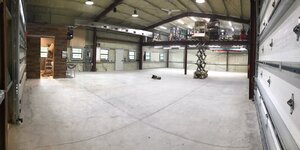

My guys and I tried to lay out the stairs and it's taking up too much room. Altering the stairs seems outright dangerous. I don't want to shorten the stairs. So I thought about it and the lift a friend lent me has been very convenient. I got all my junk upstairs with it! So I might buy a lift and put some steps up to it and or building something to pretty it up around it but then I could still pull it out to use it around the garage?

davetulk
Feb 2, 2009
101
Mid Florida
Buddy of mine had an set of stairs made out of aluminum with a hinge on the top. We then put a hoist from the ceiling to raise and lower the stairs. Works great. We just lower down when need to get something up there then back up. Northern tool electric hoist does the trick.
They were made by a company that fabs railings and gates. Just another option to thing about.
Now if you buy a lift, makes changing light bulbs pretty easy ;)

As for the scissor lift, my GC lent me his while I was running my air lines. I am so used to using them at work that I have been waffling on purchasing one for home but I think a small forklift may be a more versatile piece of equipment. Moving heavy equipment around if needs be and loading/unloading supplies would definitely be easier with a forklift. Then for when I need to reach the ceiling I could simply fabricate a small man cage and have my son or wife lift me up. Still contemplating which would be more beneficial at this point before I start looking.

I looked at hinging steps and had someone come out to give me a quote. It was going to be too much money to have them fabricate and I am not a welder so it is out of the question unfortunately.
I can get a lift around here used with "new" batteries for about $3750 OBO but I hope I can get it for around $3200 maybe? It is a useful machine and I contemplated a fork lift but you really need two people with a fork lift. Plus I don't have any high shelves I wouldn't be able to get to with this man lift...

I just checked the quote again and they wanted like $8000 for the set of hinged steps without the hoist. I actually already bought a couple hoists to mess around with but I think either buying a mobile JLG style lift or a chinese lift from alibaba. I am working on quotes now but I think its going to be cheaper to buy a used one local.

I am having a hard time thinking that you can live without any stairs up to that mezzanine. Sure, a man lift is great for moving stuff up, but you have shelves and shelves of stuff to access, it takes a bit of doing to climb up into a manlift every time you want to look for something IMO.
How about a corner stair (stair up to a landing, then 90 deg up to the mezzanine) to save some space ?

I dont want to run stairs against the wall since I really don't have a lot of wall space once I put cabinets up. I thought about building a dock for the lift so I would have three steps up to the lift and I can dress up the wheels and stuff underneath it without it looking like a driveable lift?
