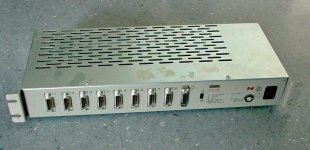

The "cheap way" into Ethernet was "Ethernet in a box" (an AUI multi port repeater - example Digital Equipment DELNI)
Ethernet was attributed to Digital Equipment Corporation (DEC), Intel, and Xerox, although Xerox did all of the preliminary work. The original spec was for a "bus" technology (the one big fat cable) and not a "star" topology (what we have had since 10BaseT) because that was "too expensive".
