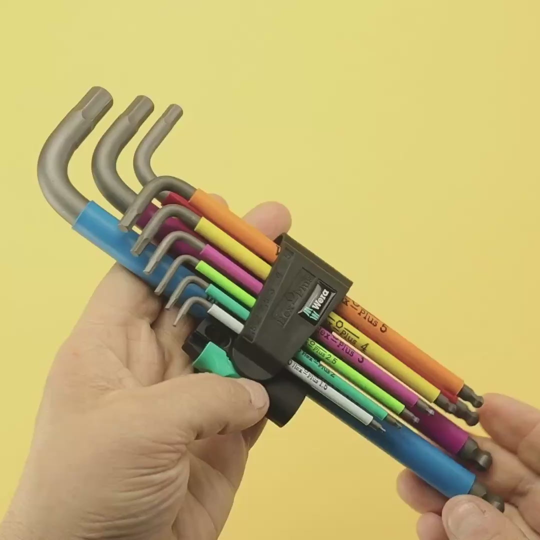

One thing I think people forget to mention about the Wera - the ends are machined from a round bar, but the round portion remains. This makes them a bit thicker and a lot more rigid. What often bothers me with standard all-hex keys is that damn flex. Even the PB Swiss 5mm hex key will flex quite a bit if you really put some serious torque through. The Wera won't, I think you'll sooner snap off the head before it has any bend. And it never seemed to cause a clearance issue for me (still smaller than the allen head diameter), so I take that as a major advantage for Wera.
I am certainly not a fan of their screwdrivers (IMO bad handle shape and easy to get dirty with no hard handle version...) or wrenches or even the ratchets (sockets are pretty good taiwan quality, love the color coding and knurling but hate that they don't stamp the sizes on! laser etching fades away over time!). But they really do good allen keys. I have nothing to fault them for. Hex-plus is basically exactly like an inverted flank-drive, which is the standard for nearly all modern sockets.
This is 100% correct!
The only thing I would add in respect of the PB Swiss, is that although they flex, they do so elastically and return to straight, rather than taking a permanent bend. I once spoke to Max Baumann who runs PB and he explained all this!
I should also point out that PB Swiss offer round shank hex keys too!
Although I’m a fan of the PB Swiss (and I still think they are the most accurately made - certainly my first choice when I need a good fit and don’t want to damage a fastener) I like the Wera too. I’d never really thought about why, but I think you’re right, it’s the stiffness - they’re a really good tool for automotive use. It’s not just the shape though, they seem to be made of very decent steel too, and I like the colour coding.
The Wera Torx keys are also superb. They’re one of the few firms to offer a ball ended Torx, and I absolutely love these. Have really needed them on a couple of occasions and no complaints.
I also like the selection that Wera offer - hex or Torx, Inch or metric, short or long, coloured sleeves or not, then repeat all the options in Stainless.
The best solution, and I know this is a real “Garage Journal” answer, is to have both!

One thing I think people forget to mention about the Wera - the ends are machined from a round bar, but the round portion remains. This makes them a bit thicker and a lot more rigid......
I'm sure you know, but not all Wera hex keys are machined from a round bar- they also sell the typical "all hex" model that's much more common.
Yes I know, and I never thought about it but I wonder how different the fit is. Those that are "all hex" are probably forged to the shape, not machined, cause machining something that long is no easy task. Maybe final grinding but I really doubt it cause they're the cheap models?
I mean, the hex-plus feel a bit sloppy due to the shape. Those all-hex are probably even more sloppy just due to the different production tolerances for that shape.
Normal hex keys are made from pre sized Hex stock, bent, sheared to length, machine the ends if ball, heat treatment, plating processes etc.
The only thing that can make a big difference provided they are using the correct steel grade and all but the worst should be is the heat treatment processes.
-Can't speak for every maker but I really doubt any of them are forged due to time involved for forging plus the fact that there's a much faster process for making the ball drivers. I was involved in the ball driver project for Eklind Tool and have made a few posts on GJ describing the machining process that Bondhaus used (indexed broaching) as well as the faster process (profilator) developed by/for Eklind Tool. Evidence from other makers products strongly suggests that almost all other makers are now using the profilator method for making ball drivers.
Dutchgray is correct about starting with a coil of hex stock fed into a stamping die where the "L" keys are fed, bent, and cut to length in one stroke of the press. I made and repaired the dies for Eklind Tool and doubt there is a better method for "L" keys. The keys for the fold-up sets were made in a similar manner. The older "T" keys were made on a 4-slide if they were all metal. The round stock with a hex on the end were likely made with a profilator. I seriously doubt any are made with an abrasive/grinding process due to the usual limitations associated with grinding.
Dutchgray is also correct in stating the type of steel and the heat treating are critical to how good the hex key is.
"Those all-hex are probably even more sloppy just due to the different production tolerances for that shape."
-The production tolerance for hex stock is specified by the company buying the stock. There are several reasons for perceived fitment to a SHCS, I've posted a couple of explanations in previous posts. It's not always the key that makes for a sloppy fit.

Nice write up. However, there are other practical considerations such as how corrosion resistant the finish is. High humidity is an issue where I live. My Bondhus keys have little to do no rust while my Wera keys are covered in rust spots. This could even out any advantages derived from precision manufacturing.
Same experience here: the Wera keys rust more easily than almost anything else in my toolbox.
Often there is a trade-off between corrosion resistance and strength (e.g. stainless steel). Perhaps this rust reflects that?
I rate these Allen keys better than the alternatives because the Hex-Plus feature works and, being still under patent protection, is not available elsewhere. You can think of Hex-Plus as the male version of Flank Drive.
Here are some photos of one of my Wera Hex-Plus keys, a 4 mm key to match the photos by the original poster. It’s interesting that the machining is a bit different from the OP’s key, especially on the tip face. Mine are probably ten years old.
The photos show the interesting design features – long round shank, visibly modified hexagon tip shape, labelled sleeve – and their effect.
Note that the Hex-Plus shape is not applied to the ball end, which is nonetheless better made than most ball ends. The ball end of my key below has never seen more torque than can be spun in my finger tips. I cringe when I see people put 5 Nm into the ball end of a 4 or 5 mm key. That’s not what they are for.
I take uncommonly good care of my tools, wiping them down with an oily rag regularly, using them carefully and correctly, and storing them in a dry location. And yet you can see several rust spots on the metal and the fading labels on the sleeve.
Note the beautifully wide wear marks on the faces of the modified hex. That’s what Hex-Plus does: it presents a subtly convex shape to the nominally flat faces of the inside of the fastener head. When you crank on the tool, this slightly convex shape deforms elastically (as does the flat of the fastener) to produce a broad contact patch (times six, of course). The risk of plastic deformation (damage) to tool and fastener is therefore reduced.
The marketing material for Hex-Plus is misleading. The promotional pictures show pointy star-shaped tips with concave ‘flats’. As you can see from my photo of the tip end-on, the reality is that the shape bulges outward just before the corner of the hex, to produce the convex shape just off-corner that I mentioned in the previous paragraph. This is the essential feature of the design. But since even professional mechanics don’t always seem to understand that steel is elastic and half of the mechanical world relies on that elasticity to function (e.g. fasteners in the first place), I guess Wera thought the reality would be too hard to explain to your average Amazon shopper. Or maybe their marketing agency didn’t understand the physics of the design.
One key benefit of this arrangement, as with Flank Drive sockets, is that it greatly reduces the downside of a sloppy fit between tool and fastener. And indeed the Wera Hex-Plus keys have a pretty sloppy fit compared to other expensive Allen keys. Don’t mistake that for poor quality. It makes for faster insertion of tool into fastener without much of a downside.
