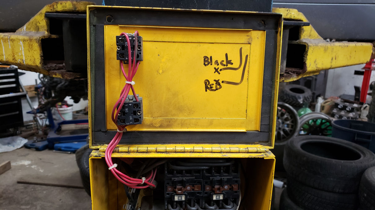

Sorry to revive an old thread but, if anyone wants me to take a picture of the wiring setup for my Hoffman Duolift GE 6500, let me know. There's the wiring at the motor for the start and run winding/capacitors, as well as at the control box to control up/down, max up, max down.

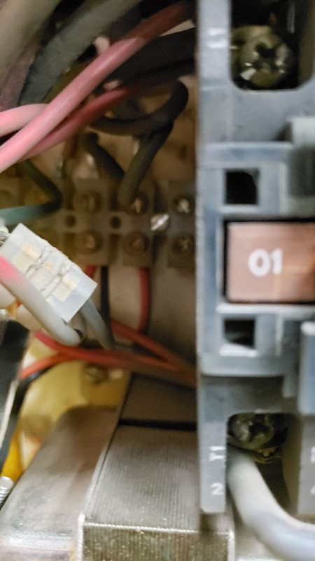

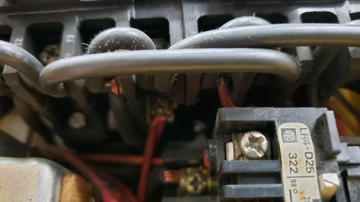

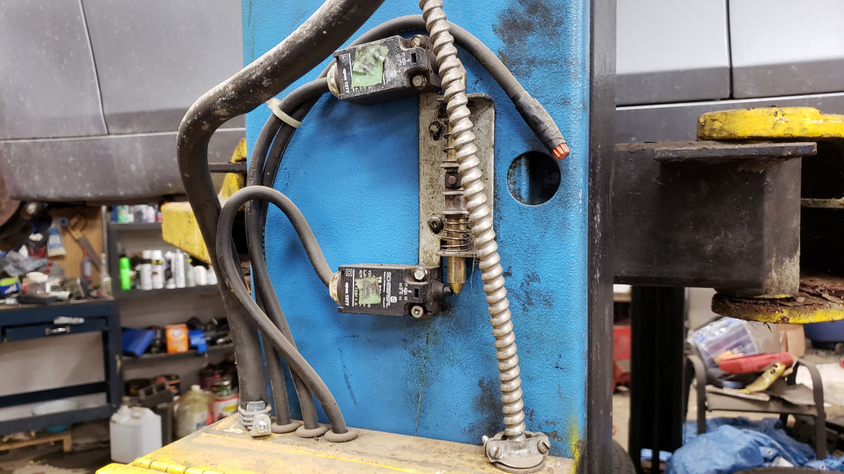

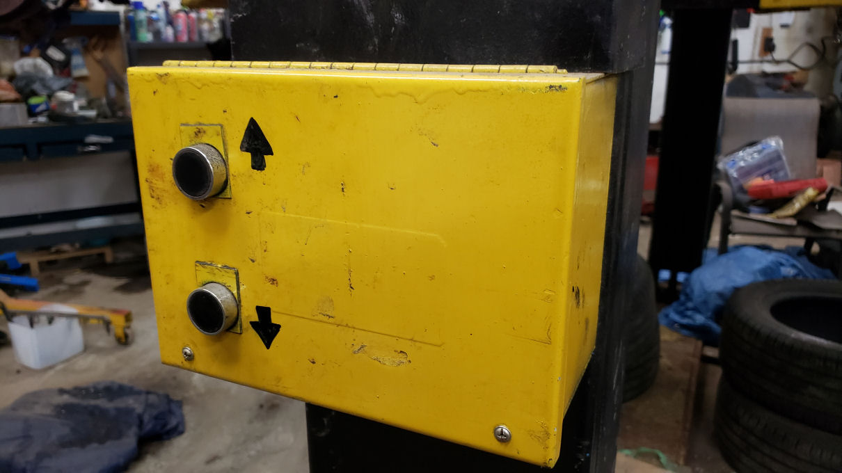

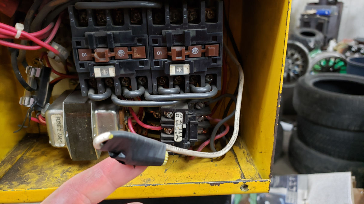

Hey djbmw:
Interested in the wiring diagram for that Hofmann Duo Lift 6500. I believe the safety mechanism at the bottom of the posts may be missing on the hoist I have so need to see how that works exactly.
Thanks JD
djbmw
Jun 20, 2013
1,164
Ottawa, Ontario, Canada

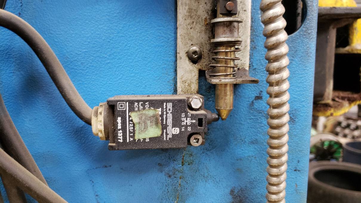

Hi Johnny - The 'safety' is just the stop relay for the "down" control. There's a rod connected to the arm on the motor side that pushes a pin down which then makes contact with the "down" relay, which cuts power to the motor. I've attached several pictures that might, or might not help:
The wire I'm touching is NOT in use, and is capped off
This pin makes contact with the switch/relay that cuts power

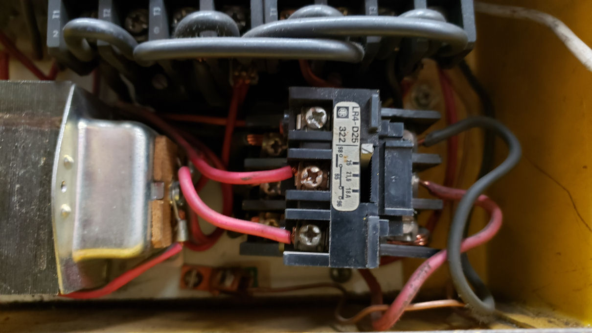

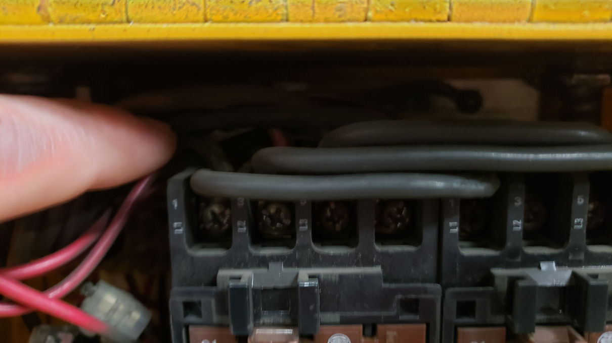

Inside the control panel:
I hope that helps

Hey Thanks so much for the great pics. My hoist does not have this rod with micro switches. Maybe I have an older model. Mine is 83' /84' vintage. Now that I've opened it up a little more I see there is a jamming nut under the hoist nut on the hoist trolley that must jam if there is a rapid lowering without the motor turning the hoist rod?
The switch box looks the same as yours.
djbmw
Jun 20, 2013
1,164
Thats correct. Now if the spacing between the jam nut and the hoist nut goes out of spec, you'll have issues raising and lowering the arm. To overcome this you can make a notch or divot in the jam nut so that you can use a punch to spin it one way or the other. I forget what the spacing/tolerance is but im sure it can be easily looked up (or just do the trial and error method :))

Johnny - without the micro switches, how does your lift determine its at the bottom, without going too far and messing up your jam nut (the same is true for max height)?
