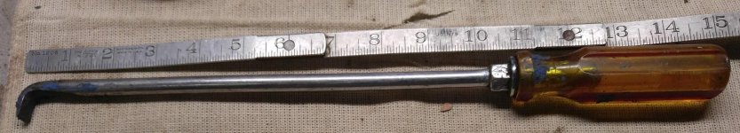

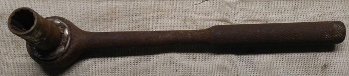

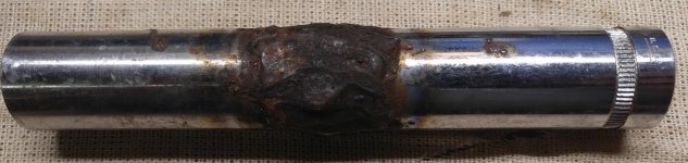

Here are a couple:
Extra long Truth Ratchet;
Custom MAC Lady's Foot / Pry bar;
Extra extra deep 3/4 socket;
Non-ratcheting ratchet / Breaker Bar.
