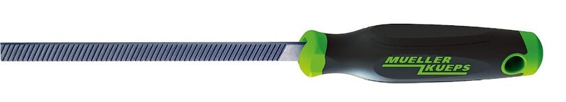

If the pin bores are good, use this file Mueller-Kueps 460 202 Thin Brake Caliper File
Pricey, but it will get you to bare metal fast.

I don't do many brake jobs either, but I have found that it the pins are tight, the easiest solution to to buy reman caliper brackets.
Those take forever. I only use that if there is no other possible way to clean the area. It's not wildly better than a sharp file.
