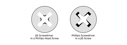

JIS is the Japanese Industrial Standards organisation. A good proportion of all Japanese industrial equipment is made under one or more of the JIS standards.
Many of the JIS standards have ISO equivalents, such as for cross point screws and drivers. In this case, the older ISO (DIN) and JIS standards were brought together resulting in improved European cross point drivers.
Current JIS cross point drivers are not identical to those of old but they are pretty close. ISO cross point drivers should be much better able to work with old JIS screws, in addition to modern ones.

I think most, if not all, of the Japanese screwdrivers are made to the appropriate JIS standard.
I believe the current JIS B 4633 is the 98th Edition, October 20, 2023.
JIS B 4633 is equivalent to, but not identical to, ISO 8764-1 and ISO 8764-2, which cover Phillips screwdrivers.
The US importer of Vessel does a pretty good job of obfuscating the standards issue.

In an effort to standardise, the old JIS and Old DIN standards were combined resulting in the new ISO standard. Much of the old JIS functionality was retained so that modern JIS drivers still work properly with old JIS screws.
JIS B 1012 defines the dimensions of fastener heads including non-crosspoint. The parts that are relevant to the crosspoint come from JIS B 4633.

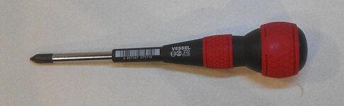

Vessel still offers a NON "jaws fit" phillips. The "jaws fit" style will eventually ****** up the fastener, as it is designed to do.
Do you know if this is just a US thing? I'm half ready to stockpile since I can't find non-JAWSFIT outside the US which makes me think they could stop production at anytime.
29,774
^ That I do not know. I've purchased all my Vessel SETS through Bowers Tool - the SETS all contained the "jaws fit" type models - those were all Christmas presents. (photo #1)
The REGULAR Phillips screwdrivers (if we can call them that) I got through other ebay sellers, but they were all US based. (I bought the "standard" tip models with those "round" red rubber grip handles.)(photos #2 and #3 below)
The "Ball Grip" RATCHETING type appear to have normal tips. (photo #4) (that package is still unopened)
The long (200mm) P2 at bottom (photo #4) has the "standard" type tip.
