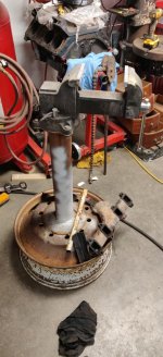

My mobile vise is on a stand on an old medium duty truck wheel.
It isn't perfect for getting crazy but it does the job most of the time.
