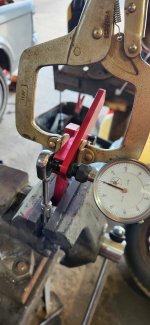

Ok dont judge me on my set up here, I let a friend borrow my actual magnetic base and we both forget about it every time we go to each other's shop.
Measured At 7 inches from the ratchet head there is exactly. 25" of movement up and down (roughly 2 degrees of movement). If you apply a good amount of pressure to it you can squeeze out another 1/16". Remember this is a G1 Icon thats about 8 months old with a pretty good amount of abuse and zero maintenance.

Picked up a G2 1/4 drive 12.5" extra long ratchet this morning for $44. The G2 has the same .008 end play but the anvil has a 3/16" (roughly 1.5 degrees) rock to it measured at 7" away from ratchet head.
If these are sloppy pieces of **** what are the SO ratchets measurements? The dual 80 extra long is $171 so I am expecting the quality/fit finish to be almost 4X....
