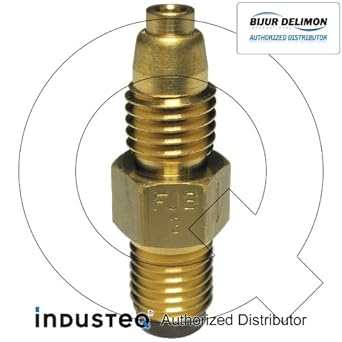

Now, getting down to business, the broken line comes into this distribution block, at the top left:
But, some of you eagle-eyed viewers might note another little problem, with the broken output hose going to the left way rail. The front way cover had a significant dent in it, so I'm assuming a piece of cut-off material, or a tool, maybe, landed in between the table and the door frame, and got crunched in there when the table came full forward. (Which is it's "home" position, as well as the tool-change position.)
More troublesome, that fitting apparently had a spring-loaded check-valve in it:
That may also be a sort of residual pressure valve, to help the oil distribute to all the corners, rather than just whichever one has the least resistance.
Either way, I now have to replace that entire run of hose, and at least one hose end with the check valve.
All before I can even think about putting the sump and chip tray back in.

Curious if you know who makes your distribution block and if they have there own specs? Does Bijur make different inserts for different distribution blocks?
-The distribution blocks on my particular machine, I believe, were probably made in-house by the manufacturer of the mill. (The chassis and major components are made in Taiwan, and assembled and wired in the US.)
I believe they were mis-machined, or perhaps more likely, machined for a different sort of fitting. Possibly something like this, where I believe the smooth end seats at the bottom of a drilled hole, such as in the casting of a machine tool, rather than something like this, which is what was on my table.
The latter are reversible- the nut and olive can be used at either end, and the flow direction oriented as necessary, depending on if you're feeding into a part, or out from a part.
The later Trak machines- and everything shown in the manuals- shows those two separate blocks replaced by a single off-the-shelf Bijur manifold, mounted to the side of the table. (Or rather, the carriage the table rides on.) I'd have swapped to that, here, except my carriage is not drilled & tapped to mount it, and there's no room in there to be able to do so. (Only about 4" clearance from the table to the side wall.)
And yes, Bijur, and other manufacturers, make a ton of different metering valves. Besides different threads and thread combinations (8mm, 5/16" imperial, 1/8" NPT, I think 1/16" NPT, etc.) there's a 'restriction rating', or whatever they call it. #000 is the most restrictive, #5 is the least, and each number doubles the flow rate. That is, a #2 allows twice as much oil past as a #1, and so on.
The restriction, as I'm sure you know, is to briefly maintain some pressure in the oiling system, so that some of the oil will go to each of the outlets, rather than all of it heading just for the one with the least overall restriction.
Your 10EE apron should have something of the sort, and my Springfield apron and carriage has three or four of them.
Doc.

-And there's the big difference. This oiler runs at considerably lower pressures than a brake line. I admit I don't know what the system runs at, but it's an oiler- it only runs for a second or two, giving a "shot" into the system. I'd wager peak pressure at the pump is less than 100 psi, and probably barely 20-30 once it sees the Bijur restrictors. Remember, the whole system is open, the oil is supposed to leak out. :)
My concern would be them working their way back out if there is any movement of the lines near the fitting. When these fail on bikes, its not due to the pressure for the fluids, is do to the movement of the hoses going into the master cylinder. They never fail at the caliper end, as the cables is always held firm and isn't moving on that end. All plastics "creep" under pressure, and movement exacerbates it. So the compression of the olive without the inner insert allows the hose to eventually collapse down just enough to become loose. Just something to keep in mind.
Doc.
On my lathe, someone had drilled one of the Bijur meters out to do just what you had described. I am replacing it with the proper Bijur connector.
Those Bijur fittings and paraphernalia are stupid expensive. I just got another tinny box from fluid line to do the apron lines and it was over $400. I think a good drug addiction wold be cheaper!
