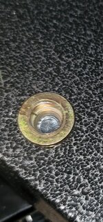

Iam installing them right now and they fit, however did youncut the side of the cabinet lip to screwed it more or did u stop where it hits?
They work but they don't go all the way in

pssst, they sell casters that attach with a threaded rod, you can probably find some that thread right into those rivnuts.
The rivnuts were there to support the weight in the cabinet on those threaded feet in the first place.
I purchased these 3/8 that fit perfect however they are only 1" long. Iam thinking about buying the same but with the steam 1.5" long so it can screw in more and caster will clear bottom cabinet lip when swiveling.

That looks great. I wish I’d seen your thread when you first started it. I have the same type of cabinets. I ordered a set of stem casters from amazon with the same thread and put them right in. I like how your wood base supports the whole bottom shelf, but I like how my stem casters screwed right in and took less than 5 minutes.
https://www.amazon.com/gp/product/B07HLKKBQN/?tag=atomicindus08-20
I got the once with the steam 1" long but I don't know gow secure they are since they don't screw all the way in. Iam thinking on gettingnthe once with the longer steam 1.5"

Yep, direct swap for the feet. Do yourself a favor and double check the thread size before you order. Make sure there was not a change to it somewhere along the way.
I used the stem castor’s recommendation from Amazon and the revitit nuts bent immediately after loading cabinet trying to roll into place I had my hands full keeping the cabinet from toppling over while unloading cabinet. I would not recommend the stem casters that screw directly In existing mount. Back to the drawing board for me. Am I the only one that experienced this bending of stem mount?
I am looking to do similar on a new Gladiator cabinet - but the wider 48in version; the threading matches 1/2"-13 bolt. The actual base otherwise shares similar measurements of 1-1/2" height, and so a 1-1'2" long stem isn't long enough to go thru to be captured by a nut on the top/inside. For those using the 1in castors, any issues with it not being secured with a nut?
also, any thoughts on installing two additional wheels in the middle of the cabinet width (using a wood cross piece to mimic the depth of the rivets at the corners -- to help level the then set of 6) ?
