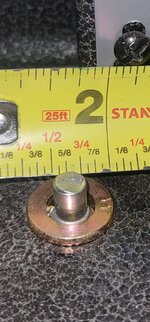

Hello,
I finally got access to my garage again and am anxious to use this COVID downtime to setup some storage. I have 3 Gladiator Large Ready-To-Assemble Gearboxes, (72"H x 36"W x 18"D), and need to put them on casters, (it's a really small garage).
Before determining what I'll use as a base or which casters to go with, I'm stumped just trying to remove the female mount the leveling feet use. I took some photos but these seem like they're flared above and below the bottom panel. As in I can't just hammer it out. I'm not familiar with common mount systems, but does anyone know how I can disassemble these? Any advice would be greatly appreciated!
From the top of the bottom panel:
From the underside of the bottom panel:

Super quick replies - thank you guys! As far as the rivnuts/ rivetnuts, when you say screw them out, how does that remove them? With my garage, casters will be on everything so I have no concerns about destroying those little babies!

He said drilled out, not screwed out. Here's a link on how rivnut are installed. Take a drill bit larger than the hole and drill off the top piece of the rivnut. Once that's drilled out the rest of it should just fall off

For your reference, this is how those rivnuts are installed. They're collapsed by pulling the threaded portion towards the flanged portion.
This is what I'd do for a simple install.
Get a piece of plywood that's larger than your box and thicker than the height of those threaded posts- I'm thinking maybe 1" thick should work. You can buy 2'x4' cut pieces of plywood at the big box hardware stores.
Cut it to the width and length of the inner portion of the tool box bottom so it can drop straight in.
Drill holes for the posts to stick through.
Take your casters and mark the hole locations. Drill and install T-nuts from the backside of the plywood where those holes need to be.
Install the casters using bolts that are as long as possible but don't stick out past the T-nuts.
Drop the plywood in place and use bolts/large washers to bolt to the existing threaded posts.

First, the rivnuts. They ****! I didn't have any bits large enough to drill out the head, so I got a chance to use a Dremel I got over the holidays, (again, looking on the bright side of this COVID :beer:). I used the metal cutoff wheel to gently cut each head, (approximately at the diameter on each side of the head). I didn't take any shots while doing this, but I think used a combination of flathead screwdrivers, a chisel, and some needle nose pliers to basically destroy the head and let the nuts fall through.
Not as clean as I'd like, but I may put a light layer of matte black spray paint around the scortched marks, (I'm going to go with shelf liner too to help things from sliding around when pushed).

futbol9
Apr 4, 2023
12
Yep, direct swap for the feet. Do yourself a favor and double check the thread size before you order. Make sure there was not a change to it somewhere along the way.
Check out the thread size of the feet currently installed in cabinets?
