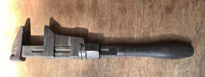

Is there a tools to remove this nut?

Are you sure that's a nut and not a ferrule of sorts that's staked in place?
Otherwise, we had tools that looked like a socket except two little nubs on the end engaged the slots on nuts for switches. I have made similar but bigger from impact sockets on the mill and lathe. Kinda the reverse of this. Wish I could remember what those drivers were called.
Found the tool I was thinking of.
13,317
Pin spanner is the tool, hook pin spanner may work too. A poor man with a welder can make an adjustable pin spanner from a crescent wrench. Or a fixed one from a socket with a grinder.

At worse case make one by grinding down a socket or something similar.
I agree, with a bit of ingenuity; flat stock, pins welded or threaded in - may come in handy when you re-assembly or do another one.
If the tail nut comes off hard; heads-up, someone may have used lock-tite on it - may take some heat.

Break the wood off so you can get some penetrating oil in from the top. Make a tool that fits the nut, hook spanners won't work. You should be able to turn the nut further on and then clean up the damaged threaded end so you can get it to come off.
16,608
I have a wrench I want to refurbish and make a new handle. Is there a special tool to remove the nut that holds the handle on?
When you find the tool that you want to use be sure to check whether the threads are right hand or left hand. I was surprised to find left hand threads on one of mine.IMG_8612.jpegIMG_8613.jpegIMG_8611.jpeg

Pin wrench (adjustable or not) is the proper tool. Or just take a piece of plate or any other scrap piece of metal, drill and tap two holes and install machine screws to act as the pins. You can weld them if tapping is not what you like.

I would say that the slots would indicate a threaded assembly. As has been mentioned, it might be best to break the original handle off (which is split anyway) and grip the nut with soft (aluminum or copper) vise jaws to unscrew it. The male threads might be peened to prevent loosening, so that disrupted area may have to be carefully ground or filed off to allow the nut to turn. Save the metal ferrule from the old handle so you can reuse it.

That would have been installed with a hook wrench.
The nut slots are too thin for that, or a pin wrench. But it gives me an idea.
I would carefully heat one side of what appears to be a nut to expand it then try spinning it off.
I tried heat and Kroil.
Going to need a blade type spanner for that nut and you will have problems getting it off, as someone has beat the **** out of that end of the wrench over time.
Well, that is the small hammer end of the tool. It looks like the back of the jaws are the big hammer side. I like these early multi-tools.
I hd not even consider that. Thanks.
I wonder if it'll be off before the stuck wheel
The wheel action is smooth now. I used penetrating fluid and a toothbrush to free thing up.
Couple flat screwdrivers with a third one to torque on them?
I had tried that. The 1/4 flat blades fit in the slots nicely. I was not able to spin the nut, even with heat. But I had not considered reverse threads.

Assuming you have a reason not to remove the wood; otherwise is the Acme thread visible looking into the slots?
If it is threaded on: left hand thread, I know your considering. Right or left hand thread will be seriously hampered by the mashed over end of the shaft; dressing it back with a file or belt sander an option?
My go to penetrating fluid is Rust Cutter by Kearney, now in Cooper Industries; incredible stuff, can be difficult to find in single can - if you know any power lineman, they will have it.
Otherwise continued use of Kroil, time, heating, tapping on it; don't forget to hold your mouth right - Good Luck.
Please take picture for us if it comes off; maybe a selfie of the expression on your face!!

The correct tool looks like a standard screwdriver with a slot cut in the center of the blade. Lots of knives used a similar nut. You could find a larger standard screwdriver and make your own.

Looks like a standard peened nut. You can usually knock it loose with a punch and hammer, or grind off the edge carefully if it's frozen.
