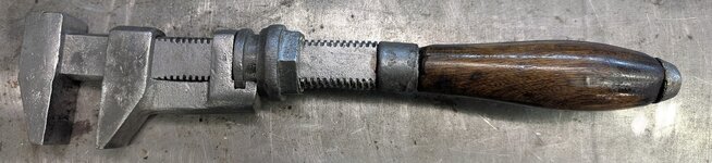

The wrong tool for the job, but what I have available. I going to go at it again and see if I can get it whiter. I am wondering if the automobile bodywork sandpaper is part of the problem. Attached are the "different sides of the handle".
-Could be part of the problem. What wood are you using? Some woods just turn out that way (resin content?). Have you tried using a fine grade of steel wool? Might not improve things but sometimes cutting (steel wool) produces a "cleaner" surface than the an abrasive (sandpaper) that imbeds particles. I'm more of a metalworker, just a woodworker as a hobby, so others might have better advice.
-Looks sorta ok for me. Having a better looking finish depends upon your expected use of this. If it's to be more of a trophy/display restoration then I can see where you'd want it to look better. If you're going to return it to duty then any dirt/oil on your hands is going to discolor the handle anyway.
13,324
Your choice of wood could be the issue also. Reusing the old handle paints you into a corner. The wood could be something that won’t turn “white”, have so much grease imbedded in it, old paint, etc that you are stuck unless you take it down a lot. Did you start coarser before using the high grit stuff, to expose newer wood surfaces? Or if you went straight to 2000, you are just polishing the old paint or grease that was already there.
I used 240 and 400.

re: I am wondering if the automobile bodywork sandpaper is part of the problem.
In my experience, numerous abrasives will discolor wood; especially silicon carbide and steel wool. An easy test is to try them on another piece of bare wood first.
16,619
I think the handle is coming out great. I would give it a coating of boiled linseed oil and re-install it on the wrench to see how it looks. It would seem to me that a handle made to look like new would look inappropriate on your old monkey wrench
Rusty and seized up as found.

I used some oil based polyurethane. I am surprised how dark the handle got. Next time I might just wax the wood. I used a steel wire wheel on the wrench. That was too aggressive. Live and learn.
