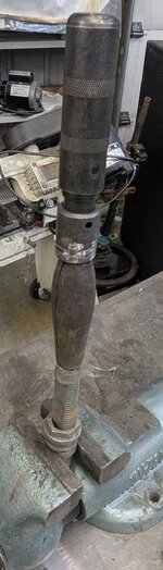

They're probably better and easier ways, but this is what I came up with. Sorry the pictures didn't post in the order I expected.
PXL_20251016_013618900.jpgPXL_20251016_014812595.jpgPXL_20251016_015639188.jpgPXL_20251016_020015725.jpg
Ingenious concept using the impact driver to break it loose; fine build on the adapter - de-nutted!

I'd run a belt sander or file across the bottom of that to break any peened edge, remove the old broken wood handle, clamp the nut in a vise with soft metal jaws and turn the wrench head with an adjustable wrench.
Edit: I completely missed there were two pages to this thread. I posted after reading only the first. Face palm.
The OP's solution looks like it worked well.
