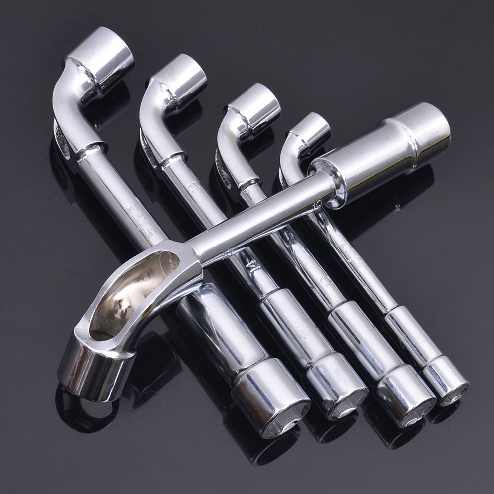

Is this wrench available in the US?
Beenman
Oct 20, 2013
486
Pretoria, South Africa
I searched through Amazon and Harborfreight but could not find anything. Anyone know if these are available in the US?
Its used as a bleeder tool for recessed bleed *******.
Thanks.
B
Beenman
Oct 20, 2013
486
Facom makes a very well reviewed set which im pretty sure are easily available in the states?
Ah thanks for the tip. I found it on the Facom website, saw that they called it an "angled socket wrench". Searching under those names I found it on Amazon (I searched under "tube wrench" originally).
:thumbup:

The OP has posted a pic of a wrench that is bent about 75° or so and is open on the backside of the socket.
All of the ones (Facom?) posted by others are bent what appears to be 90° and are NOT open on the back side of the socket.
Very different.

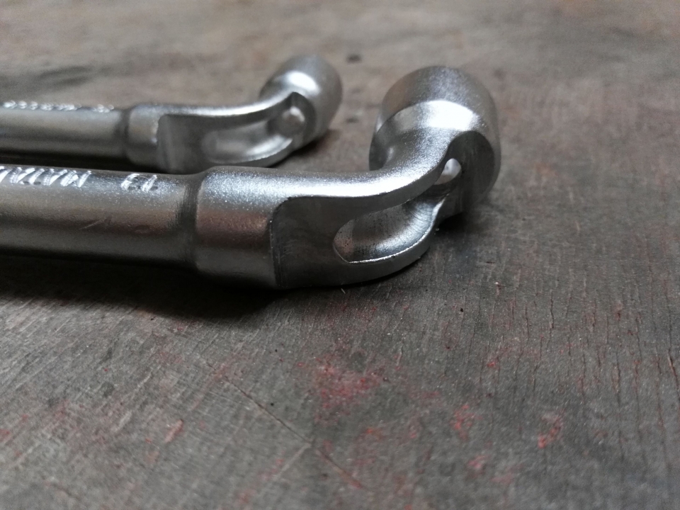

Facom is 90 deg angle and has an open end at the bent, although not visible.
This is meant for pass-through of long threaded bolt.

The facoms are exactly the same as the OP's photos, although visually look to be better quality.

In Europe they are used in place of combination wrenches. The offset gives your fingers somewhere to go. I first experienced them when I was working for STMicroelectronics and was sent to work in Crolles, France for awhile. All of the equipment techs used these. I saw one of them using them and asked him what it was he said; "It's a wrench." and looked at me like I was the biggest dummy of all time. Apparently, to a Frenchman, this is what a wrench is.
The Facoms are open on the back as well and manufactured in the Czech Republic.

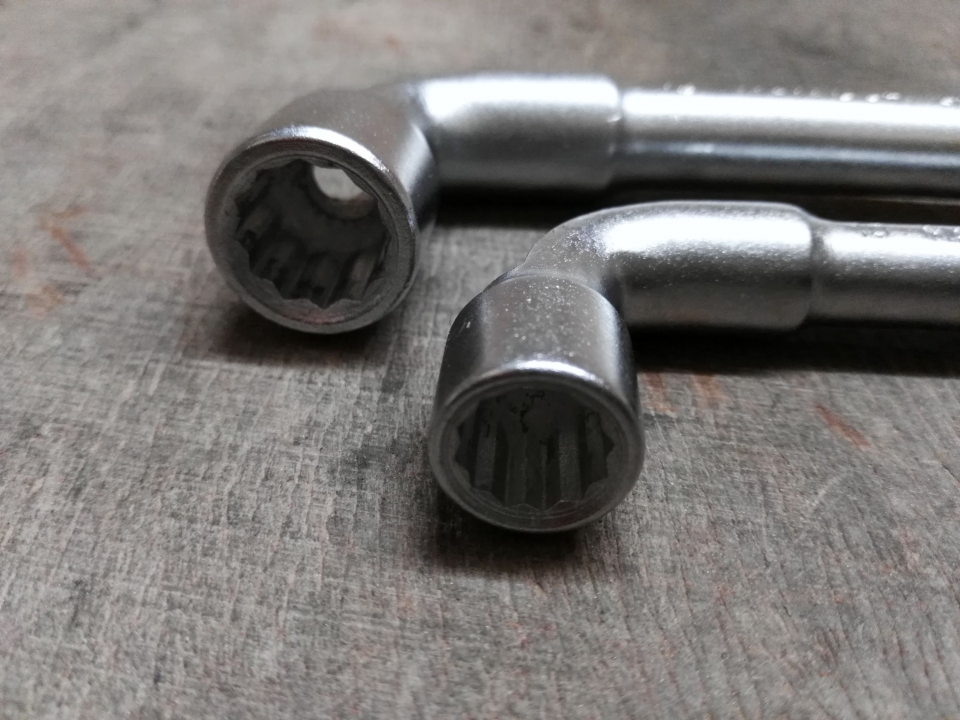

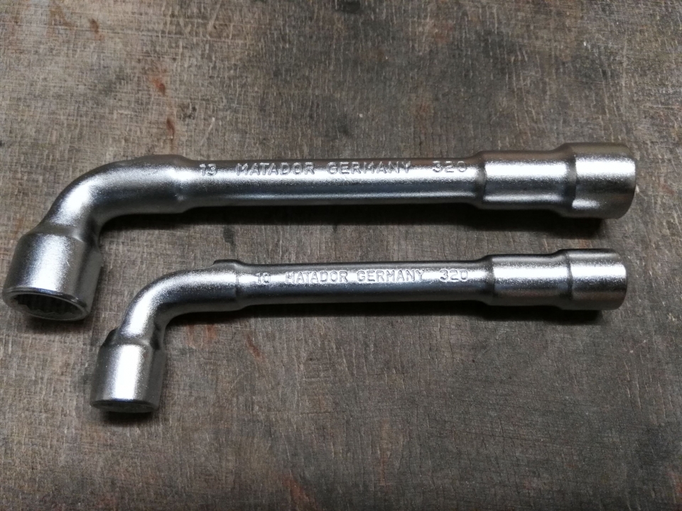

I've got several sizes of these in stock in TOPTUL that I'm willing to sell at my normal reasonable prices but I don't have any complete sets. These are 12pt on one end and 6pt on the other which actually makes the most sense. PM me with the sizes you're interested in and I'll let you know if first I have that size and second how much it would cost you.

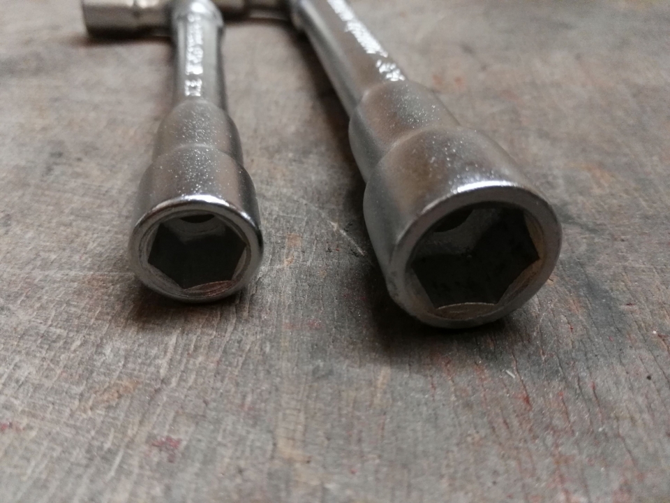

MementoMori99
Nov 5, 2015
28
The Road Not Taken
