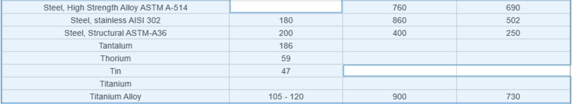

Commonly used Grade 5 Ti-6AI-4V has a higher tensile and yield strength than both low and ultra high carbon steel.

Some basic info.
Both material are at best polycrystalline. Physical properties are dominated more by grain boundaries and grain packing than by the structure of the crystallites.
Modulus of elasticity is a measure of a materials ability to resist elastic deformation. Both hammers have elastic moduli well above what is needed for my pathetic desk jocky hammer blows.
Nobody is making hammers out of grade5 6-4 Ti.
No. titanium isn't even close. Ultimate tensile for T5 is on 21,000 psi. Mild steel is around 60 to 80 K. the advantage for titanium is strength to weight.

Ti, steel, and aluminum all have mech properties roughly in proportion to their densities, meaning no one material is stronger for its weight. When selecting materials for aerospace applications, the decision comes down to manufacturing concerns, availability of raw materials, corrosion, heat, fatigue, and galvanic corrosion.
in general:
aluminum has a density of .10, modulus is 10million and UTS is around 80ksi
ti has a density of .16, modulus of 16million, and UTS around 150Ksi
steel density is .287, modulus is 28 million, and UTS of 220ksi isn’t hard to achieve.

It’s not hardness. It’s stiffness, young’s modulus times moment of inertia or EI. When you harden steel, you don’t change its modulus. There are metallurgists here who can explain this better than I can.
The equation above is important because it tells a craftsperson exactly what they need to know and affirms what they already know.
1) If you swing your hammer faster, you get a more powerful impulse. Choosing a heavier hammer might get you a bigger impulse but only if you can swing it fast. If one hammer is double the weight of another, but you swing half as fast, the heavy hammer provides no advantage. I think all of us know this innately. Momentum is mv.
2) At impact, the ”sharp” hitting steel hammer (small delta time) generates a lot of force F, enough to crush wood, break metal etc. A hammer that takes even a little longer to come to rest, a softer hammer, really pushes. You need the high force of a steel hammer to over come friction. To bump a floor board into position without denting it, you want a dead blow or soft faced mallet.
To answer your question directly: you could match the EI of a ti hammer with steel by changing its geometry. You can’t change E but you could change I. Dewalt tried this by mig welding a hard hammer head onto a softer springier handle. The head of that hammer kinda bends on impact.
