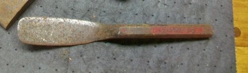

I finally found a little time to play in the shop this weekend.
The first project was bringing a Ferguson #E-6 body spoon back to life. It wasn't in too bad of shape, but there were some burrs on the spoon from someone using it as a hammer (they don't show up in the before pic). Once it was derusted, I cleaned up the edges with roloc disks. The paint isn't as bright as I thought it would be (the picture shows up brighter than it really is), but it works. (pics 1-3, before and afters)
The next two are some Billings wrenches that I picked up off of ebay to use with my table saw. The SOE is 1-1/4". The handle is bent and curved. I left the bends in it, because that makes it perfect for changing the blade as it keeps my knuckles away from the teeth. The DOE is a Billings #33 special (13/16"- 1-1/4"). I'll use this one with the saw as well. They got a polish to the faces with roloc's and the buffer, then masked and painted.
I still haven't had the time to set up the table saw. It's just sitting in the middle of the floor with parts all over the shop. :(
