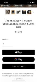

Does anyone have a preferred manufacturer? I know I can make it myself but honestly not that interested in making it since the saving difference isn’t that big.

Yeah I watched a few videos and know could make but after cost of materials and time i will almost certainly spend more.
