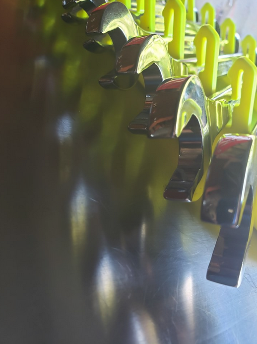

Alright just opened my set of supercombos and all of them have the groves/raised flat area, even down to the 7mm. They are nice looking wrenches and I really like the length compared to my current set of Pittsburgh wrenches from HF. One thing I’ve notices is that some of the box ends look tarnished black in the grooves. It almost looks like the chrome is flaming off or didn’t adhere but maybe this is just residue from the plating process?
Either way I’m excited to compare to the Wright wrenches tomorrow, but it’s going to be hard to beat these supercombos. I didn’t realize how much nicer the extra length was until I had it in my hand.
Wamsutta
Jan 8, 2014
10,938
Amarillo, Texas
They have to put something inside the box end to hang the wrench from while it gets submerged into the chrome plating solution. It's physically impossible to chrome plate an item entirely without a wire mark, so what they do is find an inconspicuous spot to hold the wrench from; usually it's inside the box end.

It’s more than a wire mark, it’s the entire inside area of the box end. I’ll get some pics uploaded but it seems to be worse on the larger wrenches than the smaller ones.

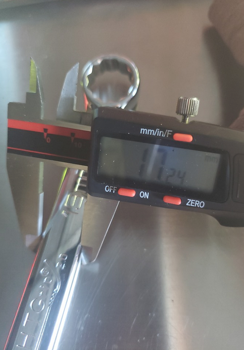

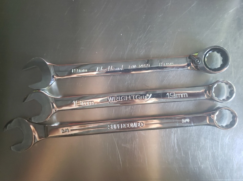

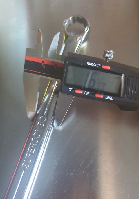

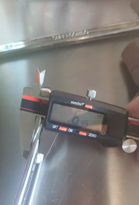

Does your set have different size stamping for SUPERCOMBO? At first I thought they alternated, but I don't think tho. Just inconsistent which looks funny.
As far as the wrenches go, they're good. I like the extra length and they feel great in the hand, but I dont like how thick they are. Seems like a little unneeded heft, but I'm just nit picking for the sake of comparison. The open ends on mine look good, tho the two smallest wrenches say SUPERTORQUE instead of SUPERCOMBO and do not have that. I haven't used them yet and may end up selling them. Not because I dislike them, but because I don't like them enough to switch things up. I think I'll get the matching Wrights, tho I have little/no intention of either of these seeing use at work. Haven't used a SAE tool in months!
Here's a few comparison pics
K
kapster
Dec 14, 2011
517
Wooster, Ohio
8 years already, forgot I started this topic. I did get an SAE set of supercombos back then and still love em. I liked em so much I got a metric set a week or so ago. However, I feel quality is slipping. A few of the open ends have horrible chrome. They all have small size markings, smaller then my sae set. To add to it, they stamped 7,8, and 9 to deep making it next to impossible to read. To bad they put mm next to the sizes, just makes it harder to read. I then started checking open end sizes with calipers, they seem to be more oversized compared to the sae set and an inconsistent amount of clearance. In researching, the clearances this metric set has sound pretty common so maybe they have increased the clearance. Maybe that isn't as big of a deal with a design like this but my old set was definetly held tighter.
I really like this length and the open end design so will probably keep them if they will exchange the wrenches with bad open ends, but it's a bummer they are not as quality as they were. I found some recent production Proto ASD wrenches at work, this are seriously nice wrenches. However, I feel the Williams open ends grip better and some of the box ends are pretty sharp on the Protos. If only Wright would make long Pattern, I'd be tempted. Might have to go to snap on but dang their wrench prices are outrageous.
