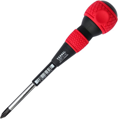

stop agonizing over screwdrivers. blow $20 bucks and discover what you've been missing all this time:
you can thank me later. ;)

Technically no one makes actual JIS screwdrivers anymore, but there is an ISO standard that supersedes JIS, and is compatible both JIS and Phillips standards. I believe this is why newer Phillips drivers are not as "sharp" (for lack of a better word) as they used to be.
That said, get the Vessel. They are among the best screwdrivers you can get, and they do fit JIS screws well.
Japanese manufacturers still comply with the current JIS standard.
JIS is the standards organisation and it still operates. The standard in question is JIS B 4633 and has been updated. The current standard is JIS B 4633, 98th Edition, October 20, 2023.
So, Japanese cross point screwdrivers are still made to JIS B 4633.
The updated Japanese standard is equivalent to ISO 8764-1 and ISO 8764-2, the same standards that cover Phillips screwdrivers. I believe the measurements in the Japanese standard are not identical to the ISO measurements but are within the ISO tolerances.
That said, I use Vessel cross point screwdrivers as they fit old JIS and Phillips head screws very well.

I just use Vessel, as for sure they fit Japanese screws since they are Japanese made. As to other brands, most new ones with the DIN5260 standard fit good enough most likely. I know for sure I have a nice Wiha driver that is by far the most terrible screwdriver ever in history to fit a JIS screw, but it's 15yrs old or more. Maybe the new ones work better. Also JIS driver is not always better for all screws. I work on Pinball machines and a JIS screwdriver is a terrible fit, but the Wiha fits perfectly. On a motorcycle use the Vessel.

You're stripping the rotor screws because they're soft rusted fasteners and you're using a screwdriver to take them out. Get a hand impact driver with a Phillips #3 and dip the tip in valve grinding compound. If you want something just for rotor screws that's specifically JIS compatible just get a #3 vessel impacta or their impact driver kit.

The Honda rotor screws are really best to use #3 and an impact driver
Agreed. Rotor screws will just laugh at your pissy little screwdriver and puny human hands.
To be clear, you need the old-school sort of impact driver that you hit with a hammer, really hard. You need a good beefy one, not the shiny flaky chrome $10 version found in certain tool stores.
This sinister black version from Lisle, for example. It's all business. Should be on the shelf at an auto emporium near you.
One of the problems here is that there are several distinct types of tools called "impact". The only way to deal with those stupid rotor screws is the old-school hit-with-a-hammer sort, not anything with a battery, air hose, or cord.
Oh, and replace the damn screws, wouldya? FFS, don't just pop 'em back in all mangled to piss off the next guy (who may be you)...
But yeah, that said, for other stuff on Toy Yoda and Honderrr products and other Japanese brand machinery (especially older stuff), get yew sum Vessel screwdrivers ASAP.

JIS screwdrivers, and the new ISO standard Phillips screwdrivers, fit traditional Phillips screws just fine because the splines full engage. However, the old Phillips screwdriver style doesn't fit JIS screws well because it's "voids" between the splines aren't as deep - so it doesn't fully seat.
Vessel, by the way, still advertises "JIS" on their screwdrivers, but like Bubba Fett said, I'm not sure they're actually JIS tips. Whatever they are, they fit JIS screws really well.
If the Vessels are wrong, I don't need to be right. Try this with a Phillips:
This is why this driver is magic on brake rotor screws. Fits like a glove *and* has the impact mechanism built in.

Buy the Vessel and be done..

I need a jis screwdriver, because all my Phillips are stripping out my Honda and Lexus rotor screws. How can i tell if my screwdriver I have right now is JIS? I found this screwdriver in my 1994 ls400 trunk from the factory tool kit, is it safe to assume this is JIS? I’m having a hard time telling the difference between the two despite there being info online.
If you are looking for JIS - J000, J00, J0, J1 ( P.000, P.00, P.0, P.1 ) then look at the IFIXIT Pro Tech Toolkit

That's the one set from Vessel I would avoid. Almost all other screwdrivers they offer are made in their factory in Japan, but these are not. Crystaline lineup from Vessel is their entry level but they're top quality too.
Huh, I wasn’t aware. I got the 8-piece set for like $30 and have been very happy. Grip feels comfortable and the tips have held up well. They’re missing the knurling on the shaft and the “teeth” on the tip of the Megadora but otherwise are very nice
For rotor screws you need an impact screwdriver. Vessel makes 5/16 impact JIS bits.
