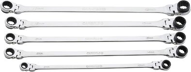

KABO COMPILATION: spline extra long flex ratcheting double box wrench
KnurledNut
Jan 28, 2011
8,287
n/a
The KABO spline XL flex ratcheting double box wrench is infamous here on GJ, mentioned often.
It is almost always found with different brand name labeling.
As such, pricing can vary greatly, depending on distributor, warranty, 72t or 90t count, etc.
The purpose of this thread is to be a repository for future reference.
If i have overlooked any brands, please feel free to add them.
While helpful discussion and updates are invited, please keep the thread focused and on the tracks.
(Im initially starting this with metric base set info even though expander sets and SAE are produced.)

Dropping some images from my digital archives:
Kabo side-button reversible:
Kabo half-moon reversible:
Kabo 72-tooth non-reversible:
Kabo 120-tooth 12pt drive
Kabo 120-tooth spline drive
Blue-point BOERMLS 90-tooth (were available at least from 2009)
Kabo double-flex 12pt
These were sold by Matco and MAC
