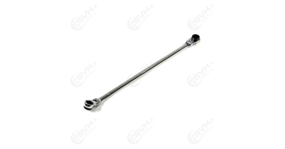

Kamasa Tools K2840(8x10), K2841(12x14), K2842(13x15), K2843(16x18), K2844(17x19)
90-tooth
It seems they are 12 point, not spline drive.Dlugi-klucz-oczkowy-dwustronny-z-grzechotka-16x18-Rodzaj-klucza-oczkowy.jpg
