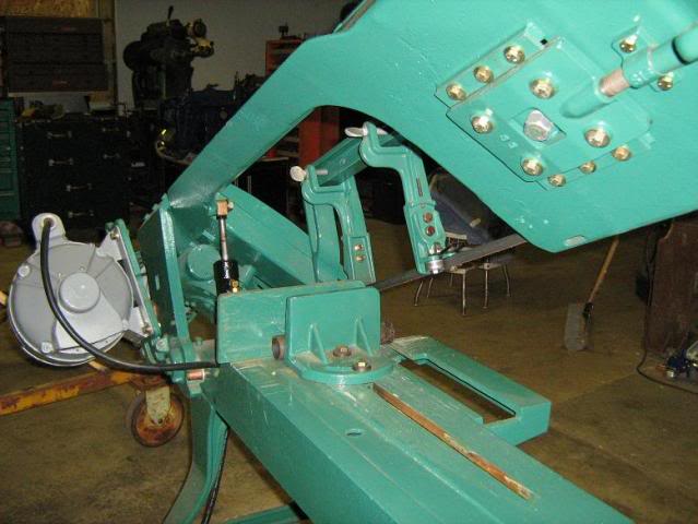

I've been working on fixing/repairing & finally rebuilding this old Kalamazoo 816 bandsaw for several years now. It's been one of those "on & off " type of projects.
I still need to get the correct step pulleys for it & make a new belt-guard, But It's finally back to fully operational without a make-shift hand feed set-up!

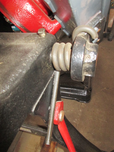

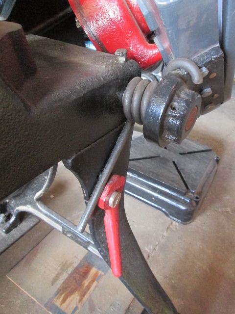

What is the stuff inside the blue circle for?
Here's a couple of closer pictures of the head weight tension spring.
The tension spring was broken & the hydraulic cylinder had a damaged return line when I first got it. That curved bar on the back-end of the saw had a garage door spring on it that connected to the bottom of the leg. It helped out somewhat with the head weight, But it was still way too heavy of a feed rate.
Now with a new tension spring & the hydraulic cylinder rebuilt, The head weight is around 8lbs. Pretty impressive since the complete head/frame/motor
assembly probably weighs over 250lbs.
Total weight of the saw is over 600lbs.
Lots of good old cast-iron in this one!

My feed spring is broken, could this be the culprit?
I would bet that the broken spring has a lot to do with the cut not being square!
Parts are starting to be harder to find for the older Kalamazoo bandsaws.
Not sure if the spring is still available or not, But I got mine from this place;
https://fdk3co.com/
The contact name I had a few years ago was Frank.
The part# for the spring was S-70 "Coiled Tension Spring"

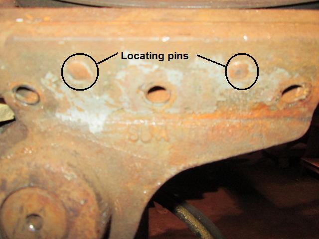

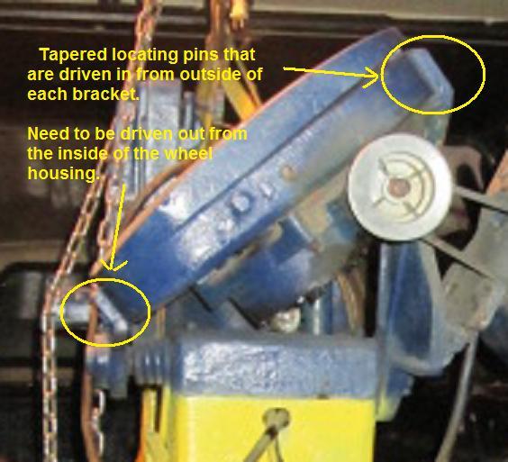

In regards to replacing the tension spring, It can be a little tricky to replace. :headscrat
The pivot mounts are attached with tapered alignment pins & they need to be driven out from the inside of the bandsaw's wheel housing.
To get access to drive the pins out, You will probably need to remove the drive wheel.
Also you will need to have some type jack or engine hoist to hold the head in-place while taking off the front pivot bracket.
Doug
