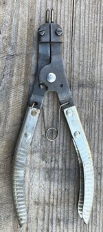

I never did manage to locate the patent that would help me date them, but, (a) they do not appear in Catalog No. 17 (1935) and (b) they do appear in Catalog No. 21 (1942), so I'm pretty sure they're late 30's or very early wartime. I did find a patent for blub pliers (1983411) awarded to Charles Smith on Dec. 4, 1934. They may be a reason why no K-D related patent can be found (i.e., maybe it was not awarded).
I noticed that I did not post a catalog excerpt back in 2018, and I am glad I looked one up today, because it gave me a big chuckle.
Check out the handwritten pencil note to self... "Use 185 Duro" :lol: (I guess somebody didn't like the K-D or it was the wrong size for someone's bulb.)

^ errrr... yeah... Duro/Indestro made that same kind of widget. Not sure if there was any patent on it, though.
I have to wonder if perhaps the handle design may have been a factor in that guy's choice. ;)
Note they're both using the same nomenclature for the same widget.
Of course they did! Did you think my discriminating PO's little note-to-self about an alternative mfgr and model number would steer himself wrong? That's the coolest part about that K-D catalog scan. The cross-references! Dude was an organized mechanic. :)

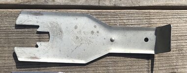

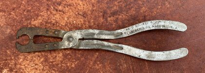

K-D No. 430 Door handle tool. Seeing the 425s inspired me to look it up. Maybe I'll try them out on my old Suburban.
As seen in the #69, 1969 catalog.
30,753
They introduced the No. 430 in 1948 or early 1949, as far as I can tell. At that time, based on the illustration in Catalog Supplement No. 24G, they were probably just two pieces of stamped steel pinned together, just like the No. 425 and many other special pliers they made. Mine (post #75), like yours and Don's (post #6), do not have the 'PAT APL'D FOR' marking that the catalog illustration shows, either.
16,594
I have both the 430 and the 431. I have used the 431 many times over the years but don’t recall ever actually using the 430.IMG_4394.jpeg

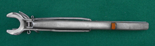

Well where would we have been without K-D tools. They were and are everywhere, and if anyone worked on automobiles back in the day they probably had at least one or two laying around. I am pretty sure I have one or two of the large valve spring tools, and I have the rotary piston-ring filer that once belonged to a deceased friend of mine and which I have often used when sizing new rings to fit cylinders. Also this is here, a nifty folding set of tools for working on the headlights of the older automobiles when things were very standardized compared to nowdays. I have in the past just carried it in my pocket as a general "get me out of a jam" tool while I was going about my day working on things.
