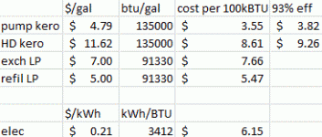

I've worked out a spreadsheet of comparative heat sources.
First, an overestimate for the price of kerosene at the pump (last winter was closer to $4/gal). Second, the stupid price of a gallon of kerosene at HD (with sales tax). Third, the stupid price I pay to exchange a propane tank around here (assuming I get 4 gallons in a BBQ tank, which is a little optimistic). Fourth, the cost of a BBQ tank refill at the cheapest place I can find. Last, electricity at my average local rate (which is WAY above the national average).
Not included are natural gas (which would by FAR, be the cheapest source), and propane from a larger tank. What I found was that propane from a BBQ tank is a nice portable source of heat when you have no electricity available, but otherwise, an electric heater doesn't look so bad cost wise if you're only running it for a few minutes to warm your fingers.
