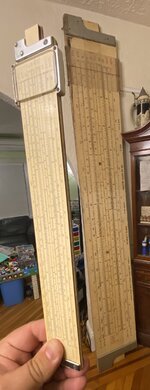

Or something similar. Their slide rules were made of mahogany coated in white celluloid.
My personal collection of K+E slide rules are all mahogany, with one exception. My N105 is an 8' replica of my 4081-3. The 4081-3 Log-Log Duplex Decitrig is mahogany, but the N105 is redwood, an otherwise quite unusual choice for a slide rule, but for a classroom demonstrator it was probably selected for it's strength and comparatively light weight. I also doubt you could find enough examples of any wood other than a conifer with sufficiently straight grain to produce slightly over 8' slide rules.
My K&E slide rule and my old man's are bamboo. My OM's is pre-WWII. Some older folding rules were boxwood.
My authoritative answer: I donno.
More slide rules were made of bamboo than probably anything other than plastic (and plastic slide rules just plain ****). I know K+E used it a lot, though my own bamboo examples are Post and Lafayette. The perfectly straight grain of bamboo makes for a fantastic slide rule. Boxwood was certainly used for early slide rules, but went out of favor when white scales came into fashion, because boxwood doesn't take well to coatings, and it's grain just isn't quite up to the marking precision required on a slide rule.
