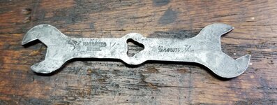

Picked this up at the flea this morning hoping it was an Aetna. It's not. I have never seen this brand (I guess that says "Crown") before. 3/8" x 7/16" open end sizes and a marking of 1/4" after that HARDENED STEEL next to that triangular opening in the middle. I have to say, that's a bit of headscratcher for me. Some companies put tap openings there.
28,712
not sure about Aetna or NB (two other manufacturers of that type of flat, stamped, DOE wrench) but Indestro made a series with a "rethreader" hole in the center (as opposed to the ones with the square opening in the center intended to be used as a tap wrench.)
not a clue on "Crown". first time I've seen the name. I just added it to the list. (I am assuming that unit is U.S. made.)
