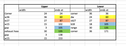

Regarding the math... I calculated it again.
- 102" of wall cabinets. 3" gap on the wall. Gets me to 105" where the exhaust hood starts. 30" exhaust hood. Exhaust hood ends at 135".
- 105" of base cabinets range starts. 30" range. Range ends at 135".
I laid it out in excel to make sure I'm not missing anything.
Did you move the end of the base cabinets down to 172" total? Because your original has 178" total and I was using that as the baseline. Here's my math:
All in all, just trying to help with what I saw (just in case), not be nosy :beer:
Yes I did. I apologize for not updating the diagram and causing the confusion. Appreciate your attention to detail!!!! Thanks!

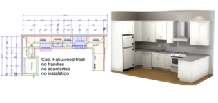

I got the plans semi-finalized. Going to pull the trigger today or tomorrow morning.
  1. As previously mentioned, I need 3 trash cans. Trash, cardboard recycling, can & bottle recycling. I found a Rev-a-Shelf under the sink, small trash pull-out. I like the idea of small trash cans that need to be dumped every 1-2 days. Best part is the trash cans come w/ lids. Unfortunately, the assembly cannot attach to the door.
  2. For the recycling I'm going to use the Base 18 on the end of the peninsula. I found a double can, pull out style drawer attachment. When ordering this cabinet do I need to request, that hinges are not added to the door?
  3. For the Base9, I found a rev-a-shelf storage rack. The required opening is 6". I measured one of the cabinets in the showroom and the opening was 5 15/16". I'm guessing cabinets have some +/- measurements to them. Fortunately Rev-a-shelf makes a 5" version.
  4. 12" uppers are not available in matching sizes. I'm going to use 42" uppers (largest available) and a 4" crown moulding up top. 36" upper above the sink.
  5. Lazy susans for the corner base cabinets.
  6. The wall cabinet to the right of the range hood increased to 33" wide from 15". The 15" wide just looked strange out there alone.
  7. Drawer base 18 to the right of the sink.
Here are the plan diagrams and a simulated picture. I also attached pics of the rev-a-shelf aftermarket items.

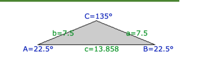

Update *** Went to pay for my cabinet order yesterday and the sales guy tells me to measure my doorways and stairwells. He needs a minimum of 35" to get the 36" lazy susan's on site. (Cabinet height is 34 1/2").
Turns out one area of the stairwell is 34 1/8". (That's assuming I take the 1"x3" trim board off).
The cabinet manufacturers make a 33" lazy susan. And according to the diagram the opening size appears to be the same (9 1/2"). I'll verify with the sales guy. See pic. If I can get all the pots & pans, etc into a 33" lazy susan, (I have 2 of them), this allows me to increase my sink size by 3" and shorten the kitchen by 3". Any downside to a 33" LAzy susan vs 36"?

The 36" should have had a 10.5" opening, the 33 will be 7.5"
That assumes these are face frame cabinets like the drawing.
12" stickout for the 36" with 1.5" lost to the face frame.
9" stick out for the 33" with the same 1.5" lost to the face frame.
If they are frameless it's only 3/4" lost but the 9/12 is the same
These are face frame cabinets. What is the angle where the 7 1/2" legs intersect one another? 135* or 90*? I'm trying to figure out the horizontal opening - to see if some of my larger pans can fit in. Unfortunately there are no 33" lazy susans in the showroom.
Thanks

jar944
Jul 26, 2010
5,900
Northern VA
Thanks
90 degrees
