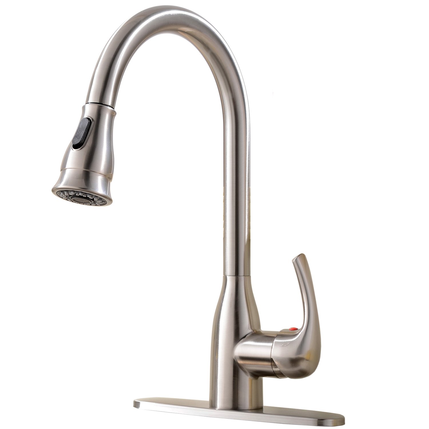

I just want a new drop in and a new facuet

I took advantage of HD special offer, 0% for 18 months and bought a sink and faucet
I wanted a single hole, zero radius, and stainless steel
