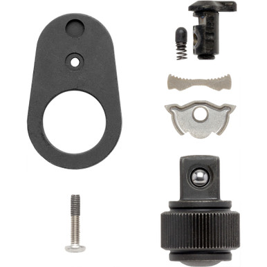

Koken Z-series 72t ratchets have an impressive design I think. Koken pawl engagement/slip doesn’t rely on springs but instead a ramp design. The amount of tooth engaging is very high and should be very strong, similar to a SO dual 80. In theory Koken having less moving parts could translate to better reliability but time will tell.
Koken z-series
Snap on
I can’t envisage how that works from the photo. What do you mean by ramp design? There’s really no spring of any kind in there?
its easier to just see how it works than me trying to explain.
I can’t get url code to start at 6:41 where it shows how rampEd pawl works.
Fast forward to 6:41
figured it out
[ youtube]

Thanks for the video, merkyworks. It’s not the clearest explanation of the mechanism, but there must be a spring to return the pawl teeth to the anvil cog after each ratchet click. That’s where the clicks come from.
I wondered for a moment if Koken had somehow used the backdrag reaction force to replace a spring (with some mysterious source of backdrag in the absence of a spring), which might conceivably work if the ratcheting mechanism could be assured to always work at speed. But no such assurance can be made for a ratcheting wrench that needs reliable static engagement, to work after storage, etc.
I’ve yet to own a Koken ratchet but like the look of them. I have a couple of Dual 80 ratchet handles and am like them. The mechanism does not only have a small minimum swing arc in theory but practice because there’s very little free play between the handle and anvil. Any appreciable handle movement engages the ratchet mechanism.
Koken z-series
Snap on
Man, those tolerances on the Koken look really tight for a shape as weird as that!

Modern CNC can easily hold .001". Just program the shape an let er go.
Yes but, just compared to other brands and even snap on the Koken looks really "tight" inside. The Snap On design looks more forgiving to any mass manufacturing deviations...
Mmmmm. Debatable. But I’m not seeing a thou in that Koken. Those pawl parts look like they were ground.
Im curious about how the gears are made. Anyone know? I would hob something like that with a CNC mill and a CNC indexing head. But are they broached? Wire edm? I suspect the answer is the reason these modern ratchets exist and kick ***. I’m guessing however they are made wasn’t available or wasn’t cheap 30 years ago.
The little “plunger” mechanism actuated by the directional switch that pushes on the bottom pawl has a spring behind it.
