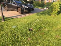

Hello Gents,
My house already had a pump for using lake water on the lawn when I bought it.
It has me a bit stumped.
When I first plugged it in it worked well. If I put a sprinkler on it, it would slowly lose pressure and then blow the breaker.
Now it does nothing.
Is priming the issue? The tank doesn't fill with water. I'm pumping about 100 ft with an 10 ft. rise.
Any tips?
Thanks
Rod

There is a strainer/screen on the end with a valve. It is clean and it is hanging under the dock a couple of inches off of the bottom of the lake.
There is a "T" junction in line just to the left of the pump. When I open it there isn't any suction.

This setup had worked for years for the previous owner.
The pick up is nice and clean as it is hanging down and the lake is a hard bottom.
There is a tank, but like I said it was empty when I did have the system working. I don't see a pressure switch.

Well, now I'm really confused.
Checked foot valve again and all looked fine.
Plugged it in. Nothing.
Primed it by pouring water in the pipe attached to the pump, closed both outlets and plugged it in. After a couple of minutes the tank started to fill up. Let it run for 15 minutes and it would not shut off even though the tank felt like it was full.
I opened up the valve to the lawn and water shot up 15 feet for 30 seconds until the tank was empty. Now it only shoots up 2 feet. Ran for an hour and nothing changed.
This thing has a mind of it's own. Maybe it's female.
