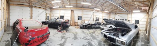

BTW I have all of my toys in the barn now, the truck and trailer are sitting outside and the homes attached 3 car garage is packed with my tools that i'll have to transfer over, but it is filling up.

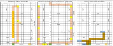

I also did some quick layouts for electrical. Air lines will run the entire perimeter and loop back to the compressor (which I think i'll keep near the panel...but not 100%)

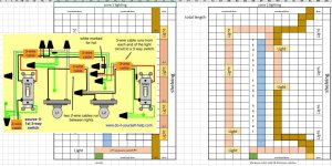

Another small update - gas line (pressure test) passed :).....now all I have is final electrical, heater and final building.
Also, I included some learned clarity on my above wiring layout...technically I need to add 14-2 either from each 3 way switch, or since I already have the wire ran as shown...from the first/last fixture of each zone. A slightly better diagram....BTW I am feeding both zones power with a 14-3 wire on a double pole breaker.
Lastly, for now, I hung one of the correct light fixtures, a two bulb LED fixture. in the future it'll be moved to the left (it is plugged into the future heater spot)....but I wanted to see what they looked like semi-installed...I am actually happy overall and look forward to installing the rest, if I get bored, i'll do a night time pic at some point.
I tried rotating and uploading the photos again, but they wont correct themselves...hmm

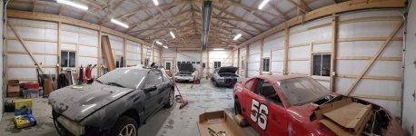

13 ceiling receptacles are now functional. 1 for a heater, 2 spare and 10 split between 2 zones on 3 way switches. 2 lights installed, 8 more to go

Heater is hung (still have to finish exhaust, connect the gas and electric, wire Tstat) and I purchased the Rapiair kit again to run the airlines :)

drivesitfar
Oct 23, 2013
36,172
Chevy: with heat i bet the progress will be amazing now. I also think i need to buy one of those nut and bolt checkers as i GET ORGANIZED. speaking of which i'd love to have you post on my thread as I attempt to get my STUFF ORGANIZED so that i can actually find something when i need it. the link is in my sig line. i have a few DIY projects too that I've done or plan to do that might help you as you get to working more on the house and grounds around your cool new home.
keep up the great work!!

Hey Drive,
i'll certainly take a look through your thread....getting organized (and planning well from the start) makes a huge difference to productivity and enjoyment....something I am still learning :)
Yes, the thread checker is awesome...I almost look forward to sorting my drawers full of random nuts and bolts!
Heater is installed and functioning, this one is a slight upgrade over the last one and I can already tell a difference. I am not sure why, but it seems quieter (although these are inherently quiet). The heat beneath the burner is not nearly as hot as it used to be and as such the end of the exhaust does actually have more heat (which is near my work station)...I look forward to determining if it is indeed 15% as advertised :)
I have attached a thermal image after about 15 minutes of the heater running, it is like mid 40's F peak temp today.

Sean- Thank!
All but two lights are installed.....its seems reasonably bright to me :p
In all reality, I am pretty impressed how far out the light spreads on these bulb. I don't even have the lights spaced perfectly to my plans (still debating on a few locations)...but it works well....although I am kind of wishing I had done dimmers instead of zones...or ideally both....but oh well.
