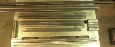

Then some material cut to length:

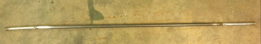

As on downhill number one, I constructed the rear axle from a piece of .75 inch tubing welded into a piece of 1" tubing and a .5 inch rod welded into that assembly. The rod extends about 6" either side of the tubing. I Welded a large washer over each end to have something for the wheel bearing to but up against.

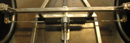

With the race just under 2 months away, my daughter brought my grandsons up this past weekend so we could take measurements to confirm seating, steering placement and overall height.
The last couple of days, I have been working on finishing the steering and the brake actuator placement.
Tomorrow, I start on the superstructure.
Here is where I am at:
View of completed steering from the front of the car.
View of the completed steering from the drivers seat.
The steering rack/tie rod assembly.

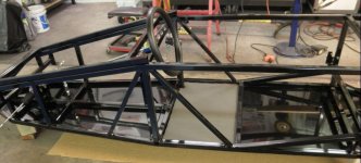

Yesterday, I piked up the chassis components from the powder coaters.
There is nothing like a little powder coating to start making a project look good.
Before, I took the chassis in, the final step was to add some diagonal bracing.

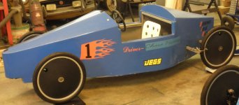

Resulting in an almost compete racer. I still have a speedometer to install, some trim and caulk work, graphics, and of course the rear axle issue.
On the side windows, I used 1/8 plexiglass that I glued in with clear silicon. I believe there will be very little pressure on them. However, since the car will be towed at highway speeds, I felt the windshield would not survive if I used that material. I went to the local plastics shop and they recommended polycarbonate - I went with 3/16.
Well here we are, all dressed up and NO PLACE TO RACE! Last Saturday, I received word that the race scheduled for this coming Saturday, Sept. 16th has been postponed till 3/31/2018!
