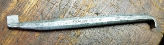

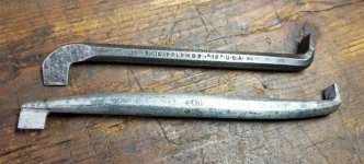

I picked up an 040 offset screwdriver and two wrenches yesterday.
The screwdriver is not branded or date coded, but I am pretty sure it's a Snap-on. The unique construction and the model number are telling. I have an 060 to go with it. See Pics 3 (with a Plomb) & 4.
The wrenches are not a pair. The electrical work wrench (J-2428) has a 1962 date code and the ignition wrench (C-1917) has a 1939 dated code. They are an interesting study in the evolution of the Blue-Point logo marking as well. See Pics 1 & 2.

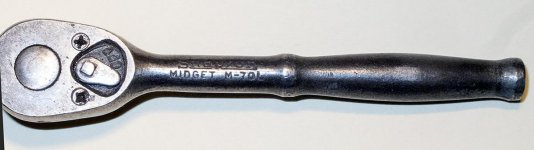

I found an old 1/4 drive Snap-on ratchet with a G code on the handle in a bin in the tool crib at Lockheed. I gave it to my Snap-on representative to see if he could tell me how old it was and he said according to their records it dates to 1937. We guessed that it might have been shipped to Georgia from the Lockheed plant in Burbank when Lockheed reopened the old WWII era Bell Bomber Plant in 1951. It came home with the rest of the stuff in my desk when I retired a few years ago.
Oldtuleguy
Nov 4, 2017
10,476
G is generally considered the 1945 date code. Also that model ratchet did not exist in 1937.
16,703
It probably came in a 9/32” drive set like this. Unless somebody modified it, your ratchet is 9/32” drive, not 1/4” although they look similar.
