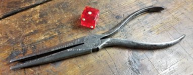

Found an early pair of Vacuum-Grip needle-nose pliers at the flea market this morning. 8" OAL. These have robust jaws that are as long as the handles, a wire hole in the jaws, and also a longitudinal pin grip (a groove in each jaw) in the very tip. No 597. Newport, PA under the pivot. Single row of suction cups. Forged Steel Products for sure, but nowhere else as appropriate to post them.

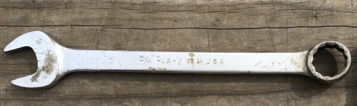

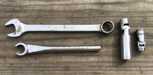

Here are this weekend’s Snap-on finds and my second Par X tool. The universal 5/8” spark plug socket went right into my regular toolbox.
