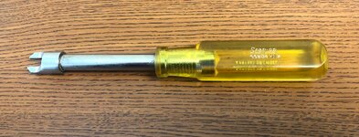

Turned up this Snap-On 55908 Handle today at a chance preview of a retirement sale from a Ford Mechanic. He said it was a tool for brake service, but being that my head was on a swivel nabbing other goodies while he was talking (I move fast on my lunch hour) I neglected to gain a better understanding of just how it's used. Any insights are welcome and appreciated. Snap1.jpgSnap2.jpgSnap3.jpg

Turned up this Snap-On 55908 Handle today at a chance preview of a retirement sale from a Ford Mechanic. He said it was a tool for brake service, but being that my head was on a swivel nabbing other goodies while he was talking (I move fast on my lunch hour) I neglected to gain a better understanding of just how it's used. Any insights are welcome and appreciated. Snap1.jpgSnap3.jpg
Dash nut tool.
Snapmom is correct. BTW, that first "5" is actually and "S". I researched a little on the Int'l Tool Catalog Library when I posted mine on ebay. Over the years Snap-on claimed use for Ford, VW and I think Porsche, to remove certain knobs and trim items on the dash of these vehicles. By the end, it was just Ford.

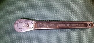

Hi everybody, I'm new here and have a question, I have a vintage 1931 snap-on 1/2 inch drive ratchet that was my grandfather's and I was wondering if I should get it powder coated. I know this would probably make some people mad, but I really don't plan on selling it. I would not powder coat the face on either side of the head or the cover plate, but the rest would have a textured black paint on it. The on/off, date stamp and screws would be painted black. My question is should I do it. I have already disassembled, cleaned and had it sandblasted. My grandfather kept his tools in good working order (it still works) and I thought I would make it look and function good. Or should I just buff it. Any thoughts. Thanks to all who reply.

After cleaning:

Since you asked, my question would be, why? If your goal is preservation, it has lasted all these years in its original finish without any extraneous treatment, and as long as there is no serious oxidation, which seems to be the case, there really is no threat to that condition.

Thank you for the reply Private Lugnutz, I don't know, asthetics I guess. Just wanted something he would have been proud to own. Although he wasn't into cosmetic things, he bought it to be used, and it might still be(doubt it though).
30,999
Was he proud of his tools in the condition he left them? These are personal, subjective decisions for collectors, even when they're not family heirlooms. I tend to have a light touch. Others like to strip and polish or gussy. There's no objective right or wrong. I would let your own sensibilities be your guide.

Z, just oil the guts, maybe a light coat of oil on the outside and then a wipe down, just to help to keep the rust down, it should last you for about the same amount of time your grandpa had it, and then you can give it to one of your grandkids.
