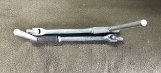

Here are some pics for context. These are all wartime (primarily 1945 "G" code) 9/32-drive tools. The hinge handle is a TM-10 with a "G" code. If I had a prewar TM-10 without a detent ball, that would show what that end would normally look like but you can imagine any of your typical hinge handles from any mfgr's set. A fully forged uniform handle with knurling and a smooth seamless end. If I could prevail upon Don to include some similar side by side photos of the end of one of his wartime surplus M-10's and one of his surplus TM-10's as long as he's pulling them out to take measurements, that would also show it. And if OTG is reading if he could add a photo of his prewar M-10 without the detent ball from the end, that would also be helpful.
