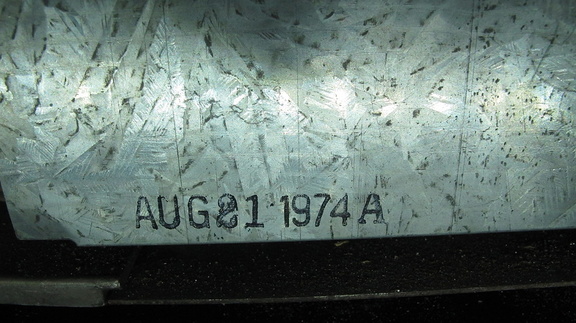

TWINS!!!
Got a second 1/2hp today... happens to be the same model # as my existing one. The new on is on the left, it's missing an eye shield and both are missing quench trays. The one I got today will also need it's lamp stalk and lamp assembly replaced.
The boys are so close together, they were birthed within 2-days of each other.

Twin brothers of different mothers!
