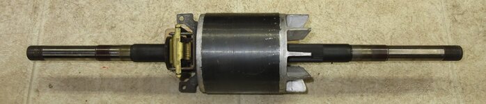

Below is a rotor assembly from a 1/3 hp square-top grinder.
Below is a rotor assembly from a 1/2 hp, 115.7575 cast iron grinder.
Here they are side-by-side. This is why I prefer the cast iron models.

More like they over built them. If you look at the size of the windings, they get progressively thinner and pull less amps.
For the two I listed, the Long C are more Baldor-shaped, and the other one is "different" enough (quench tray built in to the middle, lights, etc.)

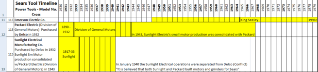

From my Notes:
I Don't have dates for Delco/397:

The Packard built cast iron "tombstone/mailbox" grinders are rugged and smooth. The last iterations used a start relay in place of the centrifugal switch. As previously mentioned, only the largest 7" grinder had a quench tray and lamp.
The subsequent Delco built die-cast (tombstone/mailbox) aluminum grinders mimicked the cast iron machines but couldn't absorb vibration like the previous models, especially with larger wheels. They are still nice, rugged grinders. Lamps and quench trays were available on all sizes. (Side note: the early model 1957 1/4hp 6" basic machine had a 2-wire power cord and no off/on switch.)
The Delco built die-cast aluminum "block" grinders (appearing in the mid-1970s) improved the vibration characteristics with shorter rotor shafts and stiffened end bells. These are nice, rugged grinders. Like the previous models, quench trays and lamps were available.
