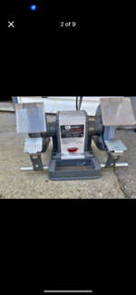

Hey guys
Which of these 2 grinders is better and why?
Both are 3/4 hp
The first, by a mile...
  • glass eye shields with metal frames vs plastic
  • better switch that can be replaced vs plastic
  • steel lamp shade vs plastic
  • heavier cast iron tool rest parts vs stamped steel
amps for each?
wheel sizes for each?

First one is 5.4 A and second one is 5.1 amp

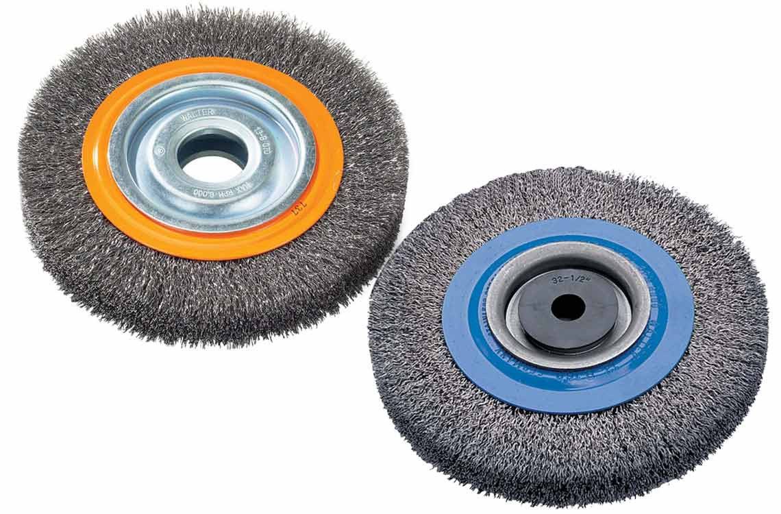

What is the best source for a 7” wire wheel — with 1/2” arbor hole?

I'm not sure about the "best" source (I got mine off Amazon), but this style is really nice for balancing:
https://www.garagejournal.com/forum...-wheres-the-love.339921/page-10#post-10171838
Unfortunately Forney doesn’t seem to make a 7” wire wheel at all.
I’ll search a bit more for anyone that makes a 7” wire wheel with a 1/2” arbor hole.
I’m afraid that 7” diameter wheels have continued to become increasingly rare, so, I’ll need to plan to use an arbor adapter (“sleeve bearing”?) on the 1/2” grinder shaft up to whichever arbor hole I can ultimately find on any of the 7” wheels that ARE still made.
McMaster-Carr has a very limited selection of 7” wire wheels (only the aggressive knot wire and stringer bead) — and none with a 1/2” arbor hole. MSC has a better selection of 7” wire wheels — but I still don’t see any with a 1/2” arbor hole. Amazon has the Weiler 7” and a few other brands, again, none with the 1/2” arbor hole.
Look up Wholesale Tool. They have loads of obsolete, NLA, and weird sized stuff like this. I’ve bought a lot of wire wheels from them because I have weird grinder needs that can’t be fulfilled with currently available stuff online, and yet they have the goods.

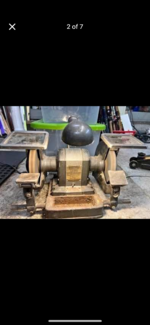

Hi all. I just picked up this 257.191500 from owner's daughter (he passed away several years ago, but she just got around to selling it). It could be New In Box, but maybe used once briefly? My question: should I just keep this in the box and buy a beater? Or is there real value in it being in such a condition? I paid $100 and knew it was a risk. Thanks in advance for any conjecture and hearsay (I want all your opinions!).
Old Radar
Apr 17, 2019
2,755
San Antonio, TX
According to info on Vintage Machinery, your grinder was built by the Paramount Division of Allegretti & Company, which was itself owned by Poulan, the chainsaw people. Paramount continued production of the Delco design for Sears.
http://vintagemachinery.org/craftsman/manufacturers.aspx
Your grinder, with Sears item number 9-1915, was offered in the 1981/82 Catalog of Power and Hand Tools.
https://archive.org/details/sears-tools-catalog-1981-82/page/30/mode/2up
It's hard to say what a "collector" will pay for most items, especially if the box is involved. You should check the "sold" listings of similar grinders on eBay to decide if it is worth your time and effort to find someone who will pay more than you did.
On the other hand, if you need a grinder and this one fits your needs, use it. If you don't abuse it and transform it into a "beater", it should last your lifetime.
(I’ve just picked up a Sears Craftsman - Model 397 1/2 hp -7” (397.19590), Design: C2372, Manufactured 1965)
I’ve used this one with great results on a 1956 and a 1957 1/2 HP model.
Ive used this one with great results on my 1956 and 1957 1/2 HP model.
I currently don’t have a picture of it mounted as I am in the middle of restoring the 1956. It’s the Orange one that needs a lot of work. I will paint it the Craftsman battle ship gray. Not power bronze that it came with. Just not a fan of it.
