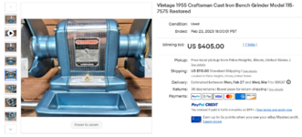

Here's another 115.7575 I picked up on 1/4. This one is dated 10 58. I hoped the original paint might clean up ok, but nope, this one will also get new paint.
2/21/2023
I finally completed the '58 this morning. I'm not thrilled with the Champagne Mist, but it turned out ok.
Did you see this one on ebay? Yours looks much better.
