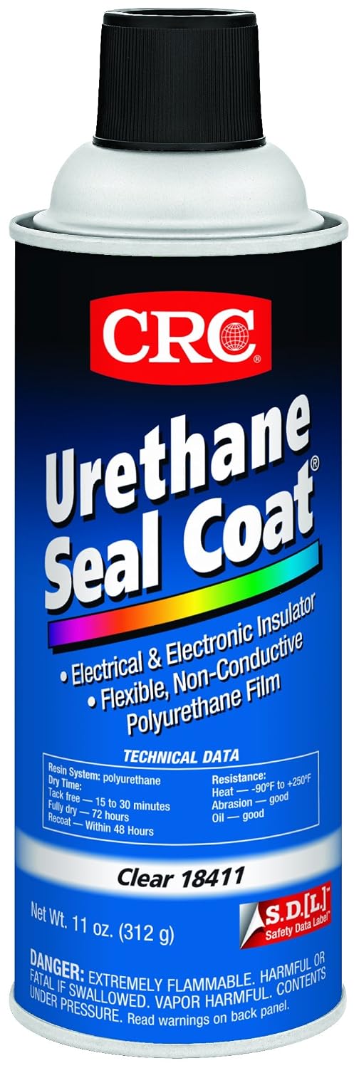

I could use some advice and help.
I've been working on restoring my 3/4hp 397.19670 with the burnt starter winding.
I sprayed the windings with urethane seal coat and I got the castings painted and the main housing assembled and wired. So far so good. But then I turned it on and after running for 15 seconds, smoke starts coming out of the winding. I tried running it a few times and it starts up just fine but soon starts smoking. :sad:
Now I'm trying to figure out what I should do.
Is it the relay that's sticking? If so, can I get a new one?
Should I look for a matching unit and swap out the relay and stator?
Should I look for a similar unit and re-use the painted castings, then sell off the remaining parts?
Should I just part the thing out and start looking for a better solution?
:headscrat
Thanks.

Is the seal coating made specifically for motor windings? (they do get hot)
Does it require a curing process? (baking, heat lamps etc...)
Did is run cleanly before the seal coat?
Have you tried measuring resistance for each of the windings to see if they are equal? (Or close to it)

Answers inline:
Yes. It's CRC Urethane Seal Coat.
The label doesn't say "Motor and Generator Winding Coating Insulator" like the image Davefr linked to, but I figured it was just a newer label design. Did I get the wrong stuff? (The red urethane seal coat on Amazon has the same label as the clear).
No.
Yes, but I didn't run it for more than a minute and the starter winding may have been overheating but had already cooked off anything that could smoke.
Yes, and I had the stator tested with a megger

JCM, did you clean the inside of the stator of urethane? Wish I could help but I really don't know much about the insides of electric things.
JCMTools
Oct 16, 2014
104
Boston MA
Not sure what you mean. I masked off the inside surface of the stator (the stacked iron that looks like inside barrel staves, if you will) when I sprayed the windings. I did wipe a light coat of oil on the inside surface to discourage rust before assembly.
nine4gmc
Mar 24, 2012
14,357
Dallas
That may be the oil burning off. Like I said, I don't know much but I think that metal should be clean and bare? Maybe someone with actual knowledge will chime in.
