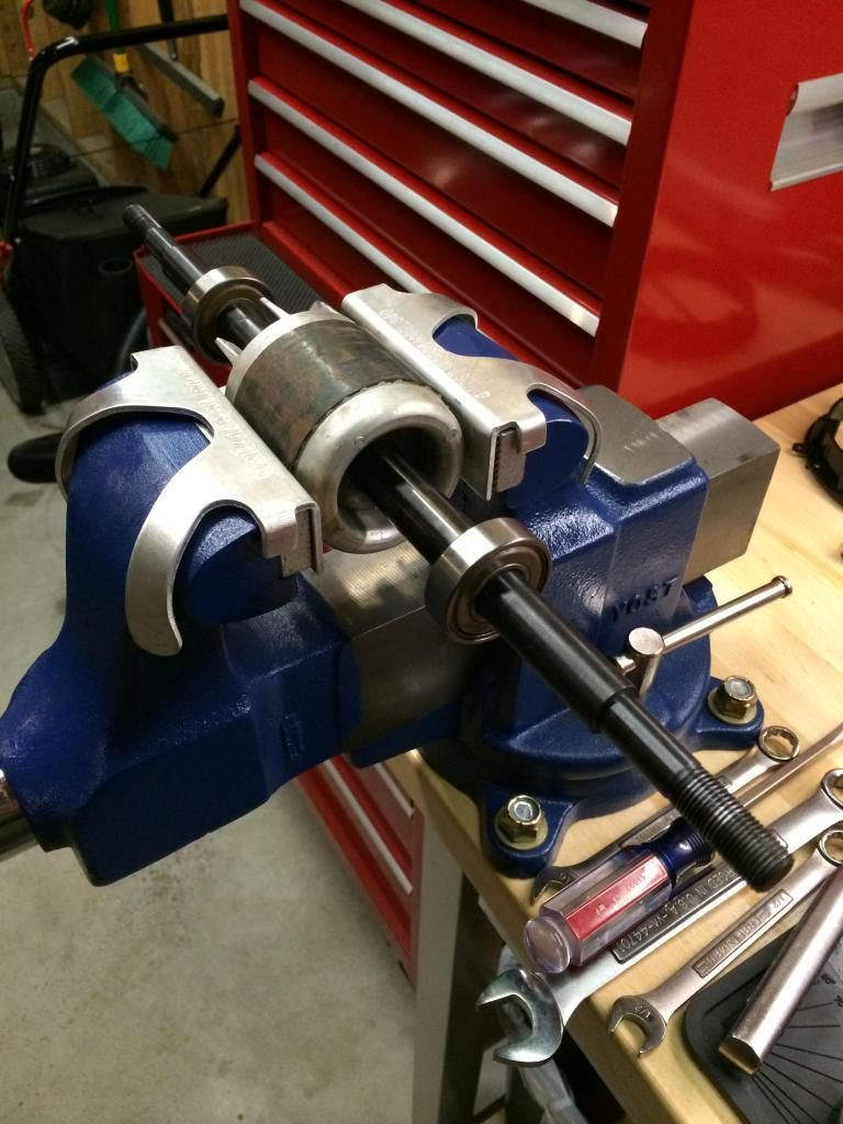

I posted this question in another thread, but thought I'd be more likely to get an answer here. How do you guys pull the bearings? I'm trying to replace a 50-year-old set, and they do not want to come off.

If you're not trying to re-use the bearings, it's a lot easier. I just put a couple of layers of tape on the face of the jaws of my vise, opened the jaws to just a bit wider than the shaft, screwed on the nut to the end of the shaft and hit the end with an old wooden croquet mallet. The nut made sure that even if I didn't catch the rotor, it wouldn't fall to the floor.
Not very sophisticated, but effective. I'm sure that the pros on this board have smoother solutions. :)

Nope, that's pretty much the classic procedure....
What model Block grinder?
I ask because there are different methods.
Some have C-clips that may need to be removed prior to removing the bearings.
http://tinyurl.com/Go-Blue-Block-Grinder
Some have RH motor cover with start-capacitor start-up switch that needs to be removed prior to removing bearing from shaft.
http://tinyurl.com/CM-GJ-Lil-Brownie-115-7566
For the bearings that stay on the shaft, I have removed them with a small bearing splitter and puller.
Protect the threads and shaft. Soak with your choice of penetrating oil (I use Kroil), let it sit. Be sure any rust or debris on the shaft that would hinder bearing removal is removed.
Be gentle and patient, the cast iron and aluminum housings can be fragile.
I don't know anyone selling parts, if something is damaged, you'll have a hard time repairing/replacing major parts.
Good luck and post up pictures of how you are doing.
We like pictures! :beer:

Thanks for the advice. The grinder is a 1/2 HP "Industrial Rated", ca. 1964. Model no. 397.19590. It has the bearings that stay on the shaft. I spent a few hours yesterday removing fifty years of grease, disassembling and inspecting. This is the current state of things:
Edit: You can see some slight damage to the RH threads on the stator shaft. It's been years since I've worked with bench grinders, and silly ol' me forgot one side had LH threads. That's what happened when I put vise grips over the threads, even with tripled-up rags underneath. Oops.

Here's a thread that might help, it shows the removal of bearings from the rotor shaft of a 1/3 HP m-397.19410.
http://www.garagejournal.com/forum/showpost.php?p=3905048&postcount=13
I've repaired threads with a small fine triangle file. Hope it works for you.

Update #2 on the "No Idea What I'm Doing Restore" AKA 3/4HP Block Buffer Build
Before:
Here's what I've done so far:
  • Took the 8" commercial grinder apart.
  • Replaced the bearings - the spin-down time did not improve, taking less than a minute before and after. A couple of causes come to mind. Originally I had an 8" wheel on on one side and for the second test I only had a 7". The 7" wheel wasn't dressed. The new bearings are non-contact sealed but they have more resistance than the old ones and I re-used the felt washers. I don't think that wind-down time is that important since I know that the bearings are good, and I wonder if the time will get better once the bearings are worn in a bit.
  • Got the crisped starter winding checked out. It looks good, but not sure if it will be long-lived.
  • Sprayed stator with seal coat (Thanks Davefr!)
  • Soaked the quench tray base in lye to get rid of the gunk build-up (still in progress).
  • Stripped the grinder parts.
  • Painted the castings with light blue hammered. (Thanks Teter!)
I learned a lot about painting with spray cans in general and hammered in particular. I rigged up a spray booth out of a cardboard box, put each casting on a separate piece of plywood and put the plywood on a lazy susan in the booth. This way I could spin and paint and then quickly put in another piece.
I used light light coats and got a beautiful finish, but it was non-hammered. So I read the instructions and tried a medium coat. I got some hammered effect but it wasn't really pronounced and and it was kind of banded - the next pass un-did the hammered effect of the prior pass. While trying to get one last corner, a section of paint suddenly sagged and I got a beautiful hammered pattern, all while fearing that I had caused a drip. So I went in for one last coat (the 7th), determined to get a good "sag." It worked, mostly, but I didn't have the guts to really lay on the paint. It looks good and I'm happy with it as a first attempt. Besides, I don't want to go overboard (ok, way way overboard) since I'm still not sure what is going to happen with the starter winding.
A couple of other things I did that seemed to work well:
I put the castings on the radiator overnight so when the house heated up in the morning, the castings were toasty and ready for paint.
Torque gave me the idea of using a slow cooker to keep the paint warm and I just happened to have one of these lying around.
16391443
Perfect for one can and it worked great!
That's all for now. More on the restoration follies as I make progress. Or in my case, 1 step forward, 2 steps back!

[*]Replaced the bearings - the spin-down time did not improve, taking less than a minute before and after. A couple of causes come to mind. Originally I had an 8" wheel on on one side and for the second test I only had a 7". The 7" wheel wasn't dressed. The new bearings are non-contact sealed but they have more resistance than the old ones and I re-used the felt washers. I don't think that wind-down time is that important since I know that the bearings are good, and I wonder if the time will get better once the bearings are worn in a bit.
JCM,
I have the same grinder and I'm doing a restore, but a little at a time. Here is my experience with bearings on a couple of block grinders.
1) The inertia of the wheels makes a huge difference with spin down times. I had two 8" wheels on this grinder (one was worn down to about 6") and my spin down time was just under 3 minutes. I replaced the worn out wheel with a 8" wire wheel and my spin down time dropped in half. Nothing else was changed on the grinder.
2) Sealed bearings don't seem to spin as long as shielded bearings. Both are suitable for block grinders from what I understand.
3) Spin down time doesn't mean much! :) What you really want is smooth bearings. My 3/4hp with the 3 minute spin down (pre wire wheel) has a "click" in it that you can hear when it is slowing down. So, I have ordered a new set of shielded bearings. Since those will be packed with new grease, I expect my spin down times to drop some more. A smooth running machine is the goal of a rebuild.

Well put JCM, I agree. :thumbup:
Over on OWWM site, there's a group that believe a long spin-down time can also indicate dry or no grease.
I'm in that camp. Long spin time = dry bearings. BUT long spin down also means the machine is in good working order, just needs new bearings. imho
