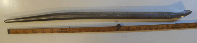

I picked these up about a month ago. The Herbrand name is in lower case and I'm having a time trying to find out the date of manufacture. Any ideas? Thanks.
30,058
I'm going to assume that the "ON" in your location field is "Ontario", correct?

I think you nailed it. Thank you for all the information! I am from Ontario Canada. I cleaned up the logo with some steel wool. There is no COO or part number anywhere. I had a good look today. Another piece of Canadian memorabilia! :love:

^ Unfortunately, after Triangle Corporation took ownership of Herbrand and moved all the production facilities to Orangeburg, South Carolina in the mid-1960s, it would appear that marking every item going out the door with COO (country of origin) was not a top priority.
I own too much Herbrand from the Triangle era. I was originally of the understanding that it was all U.S. made, but after several back-and-forths with twertsy and really looking closely at the stuff, I think he may have been correct: some of their product was being outsourced, but we do not know from where.
THAT is why I very carefully wrote that sentence above - it's possible that it's Canadian-made, but I can't say that for certain, any more than I can say for certain those two sets of 3/8" drive metric sockets (pictured above) were made in Canada.
With absolutely no empirical evidence to support the claim, both twertsy and I think there's a possibility some of Herbrand's product came from points unknown that were not on the North American continent. (Is that vague enough?)
I DO own a beautiful, nicely-finished full set (shallow and deep) of Herbrand 1/4" drive metric sockets, all of which are neatly stamped "CANADA". (Absolutely no idea where they are at present, however.)
So we KNOW that the Canadian plant WAS marking stuff "CANADA" - and we know at some point they stamped stuff "U.S.A." - and we know there were several years where they just conveniently forgot to tell us where the stuff was coming from.

Clear as mud for sure but I appreciate all the information! Your tools are in immaculate condition!
Ya know, when I first saw these, I did a bit of research and my very first thought was "Did they shop these out"?
Well, they're Herbrand and they're welcome addition to my small collection of misfit tools :cool:
30,058
^ I did not notice it at first until you posted the new photos:
YOUR piece is marked with a Capital "H" and lower case "erbrand" - which follows the theme seen on those chromed metric (12-point) sockets (none of which are marked with COO - they're in a box here right next to me, as it turns out.)
Purely speculation, but I'd call that an indicator there's some relationship between your pry bar and my sockets - era or point or origin perhaps.

I would think so. I did notice that right away on the sockets you posted. They must be long lost relatives.
31,039
upper case serifed "H" with lower case cursive serifed and italicized "erbrand"
Even though the capital "H" is sans serif and the letters in the lower case "erbrand" are not quite as leaning (italicized) as these 60's examples, and the entire marking ("Herbrand") on that pry bar is not nearly this stylized, I'm thinking it's meant to evoke the same theme and that it could be from the same era. At any rate, this is the logo that 4.c is referring to.
