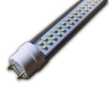

Don't buy there, that was just a quick tease. Just look for the F15 T8 LED bulb. Avoid Plug n Play, some want starters present. Some potential options, should be around $15 based on past experience with other LEDs
Hmm, my favorite vendor doesn't have 18" versions.
